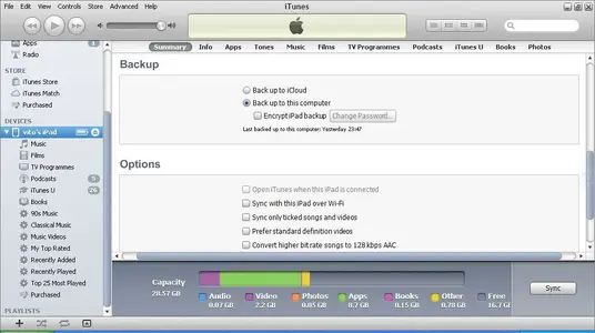

as you said i am trying to make sure i have a GOOD back up first ... is the click in this screenshot right? do i need to sync also contacts and emails (i dont use a mail client, only yahoo and gmail within email ipad client?
many thanks indeed
Vito
Yep, that's good. By the way - by good back-up, I only mean that it gets done with iTunes with no errors. As long as iTunes gives no errors - you're fine.
The backup will also save your contact info, so there's no worries there. And, I believe iTunes will also back up your emails, too. I know for sure it will back up your settings. But, if the actual e-mails are on the server, it won't matter if it doesn't...
