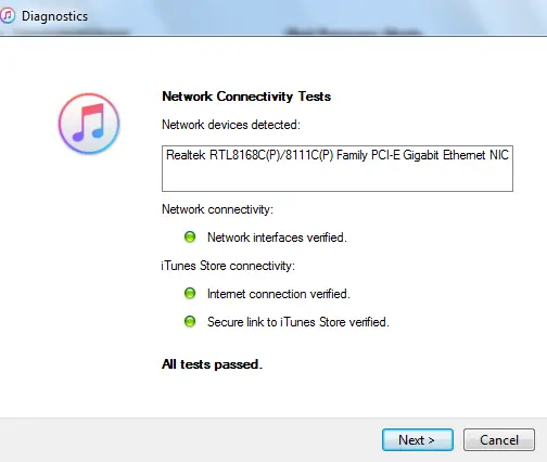

yes, but just tried iTunes diagnostics and got this-

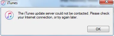

then tried to update iTunes to be sure and got this-
does this mean I am not connecting to iTunes properly???
then tried to update iTunes to be sure and got this- View attachment 65936
Your computer doesn't allow iTunes to connect to Apple servers. That's also the reason for your problem with installing software on your iPad. During the process, iTunes needs to connect to Apple servers to verify the software version.
You'll have to find out what's preventing the connection.

sorry to be a pain but does any of these screen shots give you any ideas???----
these images where taken whilst ipad was connected to pc..and ipad is showing in iTunes as needing update/restore.
ipad gets as far as the apple logo with progress bar underneath then few seconds later reports error (40).
UPDATE= I just ran diagnostics again with ipad cable disconnected and I had excactly the same results.......maybe the actual cable I am using????? will try a different cable tomorrow and report back. thanks again.
