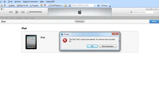

i tried to restore the software using iTunes ( under windows and under MAC ) but an error appears after downloading SW update an d starting extracting files , the error message is "The iPad Could not be restored , unknown error occurred "9" "
i searched the error and following all procedures mentioned on the web site but still the same error appear

Error 9
Error 9 is a USB communications error.
This most often happens if you are not using a genuine Apple iPad cable. Not all cables are the same, even older iPhone cables which are made by Apple do not always work when restoring a newer iPad.
Try and alternative cable if you can.
Also, ensure you are not connecting to a USB hub (regardless of whether it is powered or not). Try a different USB port on your PC.
Finally, make sure you have all anti-virus, anti-malware, and any other "utilities" shut down when you try and restore. They can often cause problems.
Good luck.
