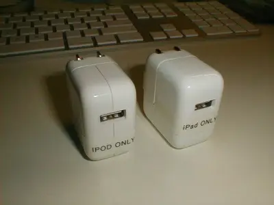

Oh, for heaven's sake. Here's a photo of the chargers, side-by-side, labels added by yours truly. The iPod in question is a 1st generation Nano, and its charger looks pretty damned identical to the iPad's, doesn't it?
Someone has already replied that it's not going to hurt the iPod if you accidentally plug it into the higher-capacity iPad charger, and I have verified that with a third-party charger. However - I did call Apple Support, and they did tell me there was the potential that plugging an iPod into the iPad charger could damage it. Probably CYA, but fair enough. So I've been keeping these chargers separate ever since. For the record, my wife fried our WiFi access point (not an AirPort) by plugging in the wrong power supply, so we are wary of making the same mistake with newer equipment.
Yes it is very close in appearance. I used my daughter's iPod Nano's charger and plugged it into my iPad. It was not easy to get out! It is not a perfect fit to say the least.
After that I marked hers with her initials.:D
