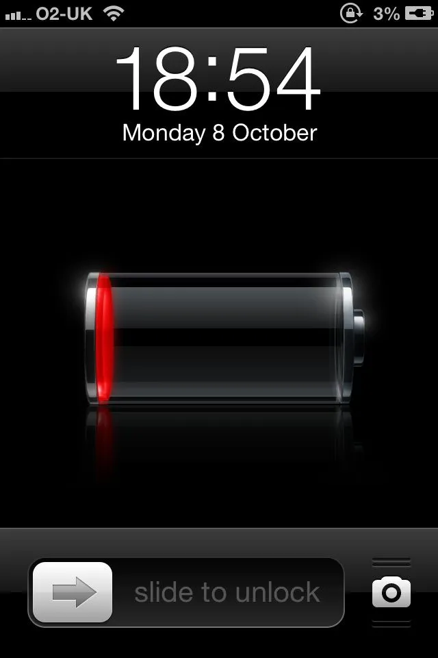

It's a bit of a hassle to reach that point of the battery but essentially it is a more modern version of this sign > image.webp but the iPad is off instead of on.

Okay, thanks for the pic.......
Well, let's look at some other things first........it may be the cable and plug instead, it may not be charging.....do you have another to try?
One of mine sparked when charging and died on me and luckily I had a spare. If I hadn't seen it happen, I wouldn't have known. So try a different one and see if it makes a difference. If you do have an iPhone charger, be aware that this will only do a trickle charge so will take a lot longer to charge an iPad. Also try plugging it into a different wall outlet also.
Let us know how you go......
Thanks for that pic. Looks a bit confusing...
1. 3% charge but the sign on the small battery at the top right shows it fully charged, and there is no 'NOT CHARGING' indication.
2. iPad is automatically turned on when you connect it to a charger, so your iPad is turned on.
3. Is the battery of the iPad draining further?
4. Is it being recognized by iTunes when you plug it in to your computer?
Also try the suggestions given by Leelai.
One more possibility: some third-party USB cables and chargers no longer work under iOS7. If you're using one, try the Apple product instead.
