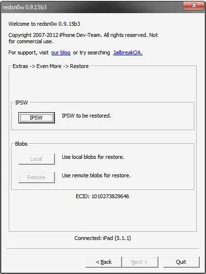

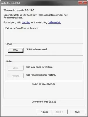

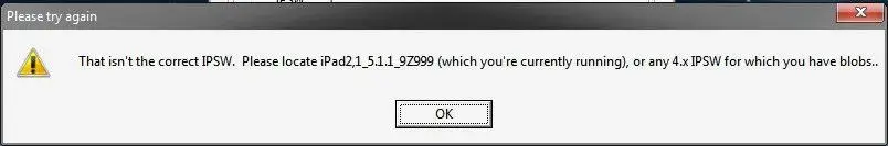

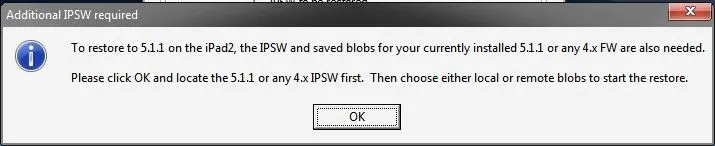

I am trying to follow the tutorial, but after I do step 6 I get the following pop up messages. After the first message pops up I select the file "iPad2,1_5.1.1_9B206_Restore.ipsw" which I downloaded from the tutorial page. Once I do that, the second pop up shows with the error. The last picture shows the blobs options are greyed out.
I'm thinking it may have something to do with the version of 5.1.1 (9Z999)?

Your build doesn't match. The re-restore feature would reflect the build type. The only clean and simple way to get you back to 5.1.1, would be to upgrade to 6.1.3 and downgrade back to 5.1.1. Again, as the sticky that f4780y has already pointed out, you'll need iOS 4.x blobs and iOS 5.X blobs.
