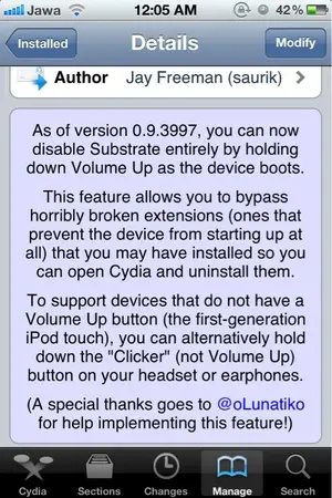

Ahhhgggg I dont believe it. I have spent all day installing my favorite tweaks and now my ipad 2 is stuck on the apple logo. Tried everything but no good. I really cant face restoring and jailbreaking again. Seriously fed up now:(
Hold power + home until the screen goes black then release both and hold volume up during reboot until it finishes booting. This disables substrate entirely so you can remove whatever tweak is incompatible with your current build.
Nooooooo!!! I didnt know that one, I've gone and restored it now I'm too impatient!!! I googled it as well but came up with nothing useful.
Thanks for that tip, I'd never heard of holing the volume control up after releasing the two buttons, I'll know for next time, cheers
It's a relatively new feature, It was released in April. At least you know now. :)
