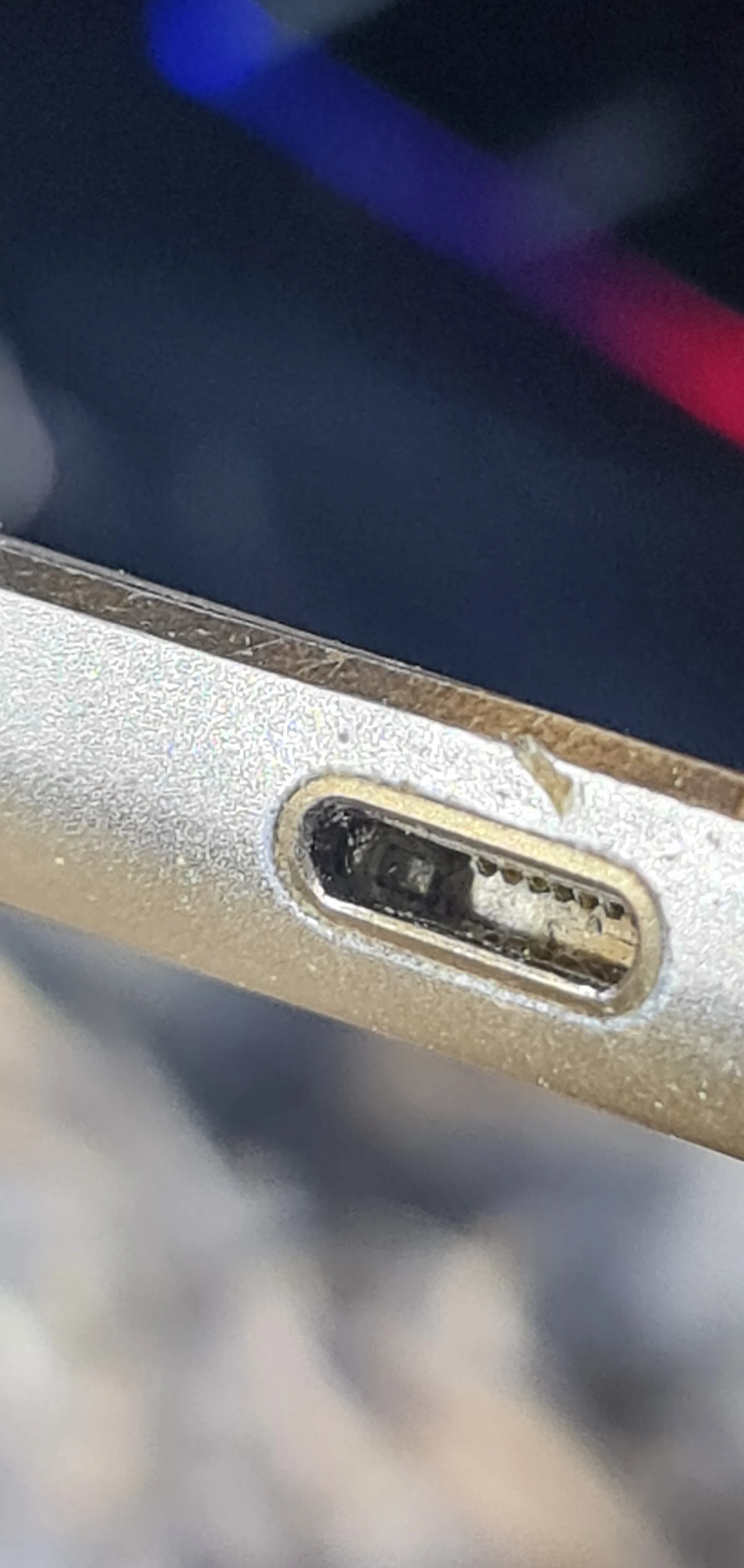

Hello,
I have an Ipad Pro. It will not charge. I wonder if it's the charging port. Please see attached photo. Is that generally how the inside of a lightning port should look? its the first time I have needed to look so I genuinely don't know.
Thanks
Jimjim

Besides being a bit dirty, there appears to be something blocking a couple of pins on one side. This is the best site/picture I could find on the web for comparison.
You could try using a plastic toothpick to try and (gently) dislodge the blockage.
