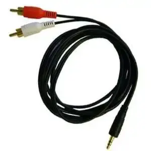

Hi again - not sure what type of amp or receiver powers your speakers, but you need the iPad to 'interact' w/ that stereo unit in some fashion; I'm assuming that a 'wireless' option is not going to be possible. But, if you can set the iPad to play your songs randomly (or in whatever 'playlist' you designed), then you could use a 'wired' solution, i.e. quick, simple, & cheap!
As another example, I have a 'mini-stereo RCA audio adapter' hooked into one of the 'AUX' inputs of my NAD receiver in my den (like the pic below) - when I want to listen to music on my iPod on my 'good' speakers, I just plug it into the mini-stereo plug and am set to go; SO, if you don't need direct control of your iPad, then a potential solution? :)
