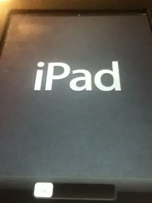

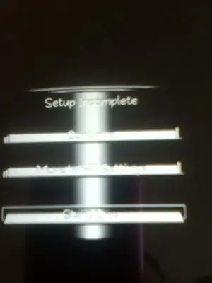

I did a hard reset yesterday and it scared the daylights out of me. I noticed on both my stock iOS iPod Touch and my jailbroken iPad 1 iOS 5.1.1 were hanging in the "Installing..." stage when I downloaded official App Store apps. So I reset my iPod, and that fixed the problem. I wasn't sure whether or not I could do the same on my jailbroken iPad, but I didn't see any other option so I tried anyway. When I turned it back on, it stayed in the Apple logo boot screen for a scarily long time. Then it went to the screens in these following pictures below. I had no idea what was going on (is that what DFU mode looks like??) I could hear it making sounds when I got an email. So I reset it again, putting it in safe mode manually with the Volume Up technique. I uninstalled every Cydia tweak I had. Then I reset it again. Still was in safe mode, or a mode that wouldn't let me open official App Store apps. I would touch the app icon, and the screen would fade as though it was going to launch the app, but then it would immediately go back to the home screen (is that the springboard?). I dunno. Then someone had an idea, that I should log into the App Store. So I did. It asked for my password and then I went back to open up a the official iPad Facebook app and it worked. Since then it's been fine. What the heck happened?? How do I find out what I did wrong?! I'm glad it's better, but it sure was scary!
