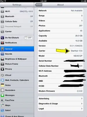

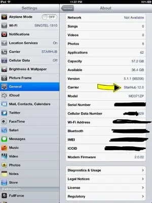

A friend had this problem on his jailbroken ipad 3 few days ago.. Tried to re-restore & re-jailbreak again but still could not get the 3g signal.. All the signal he receives was the edge network & 'circular logo' network everytime..
Went to Apple care centre & the care centre guy told that an ipad would not likely have a signal problems.. It would either be sim slot unable to read sim card, faulty sim card or service provider having technical issues..
Went to the service provider, changed into a new sim card but still couldn't get the 3g signal.. The service provider guy even take the initiative to try his own sim card & put it on the ipad but yet still no 3g signal..
My friend then call me up saying he wanna borrow my ipad which is a stock ipad 3 on ios 6.0.1.. He then placed his sim card on my ipad intending to experiment which is causing the faults & few minutes later a message pops out..
CARRIER SETTINGS UPDATE message.. Installs it & managed to get 3g on my ipad..
Took out his sim card & put it back on his ipad & finally he managed to get the 3g signal till today?
Maybe this helps, maybe it does not.. Hopefully it helps..
Also I noted that his Sim card carrier is different when slot into his ipad & my ipad which is indicated with the yellow arrow in the picture..
