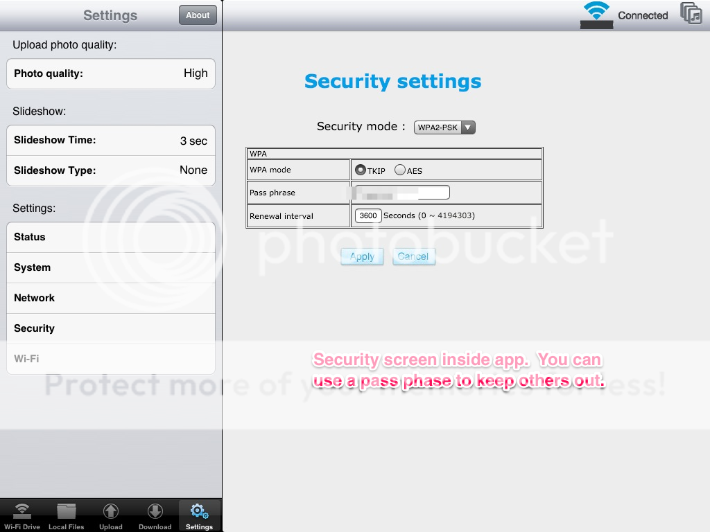

Security: This screen lets you turn on the security you will be using to keep others out of your device. It has WPA TKIP and AEC. And you get to set a pass phrase that is top secret.
