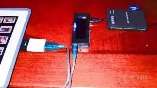

Yesterday I received a DTech Solar Powered USB hub, which I got via Amazon UK.
The item is a little wider than an CloudFTP unit with a solar panel on the top, for USB ports down on side and on the other side a small switch to turn on a torch light. At on one end is the torch light bulbs and the other has a on/off switch and a mini USB post. Also with the unit comes a USB cable with the standard USB connector at one end and a mini USB connector on the other end.
The unit has an internal battery that can be charged vis the solar panel (I have not tested that) or using the supplied cable connected to a mains charger or PC. Along side the solar panel is a small panel that has led lights; red shows it is charging, blue shows that the hub is powered.
Using the iPad Camera Connection I connected the hub to the one with the USB port, connected a multi card reader to the hub with a card that had image files. Connecting the CCK unit to the iPad it would not work but when I switched the hub on I able to import the pictures into the iPad's photo album.
At this point I do not know how long a charged unit would last.
The unit came with no documentation, nor could I find any documentation either on the net.
