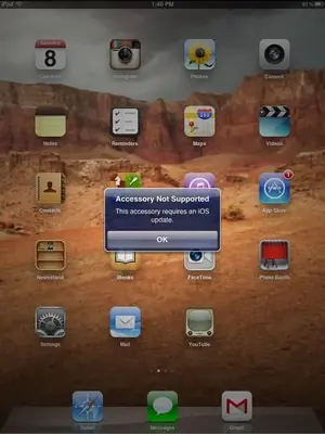

Well I went to best buy today and spent the 39.00 for the dongle. The exact one discussed above. When I plug it into the iPad 2 I receive a message that the accessory is not compatible and an iOS update is required. This is a problem because For many reasons I do not want to update. I have spent hours trying to get this to display to my tv including using various cydia tweaks and nothing seems to work. Any advice before I return the adapter ?

Just to confirm, you got one of these right? Did you connect an HDMI cable to that adapter and then to your TV? If so where/when did you get the update message, when you plugged the adapter into your iPad or when you plugged the cable into your TV? Because I've been using this same adapter on my iPad 2 that's never been updated with no problems. Something doesn't make sense. If you're using the 30 pin adapter there's no reason any update should be required.

Yes. I got a genuine apple 30 pin connector made my apple. I purchased it at best buy and paid $39.99.
The message appears as soon as I plug the adapter into the iPad. The hdmi cable does not have to be connected and I still receive the message. I have the same iOS on my iPhone 4 and I receive the same message when I plug the adapter into my phone.

Ok folks, I just want to confirm that today I received the "older" genuine apple av adapter from amazon. It to does not work on my iPad 2. I get the same message "this accessory requires an iOS update"
I just don't understand it. The iPad 2 is simply supposed to mirror right onto my HDTV.

But that's just it.......they don't. Apple changes the adapter once the iPad 3 was released. I tried both and as you can see from the photo......they don't work. This was a genuine apple av adapter for hdmi.

That's the whole point of this topic. We know it should work, but from what you see in the above photo......it does not work. At least on my iPad2.
