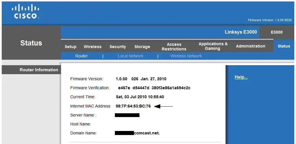

Thanks Balibe. Forgive my ignorance, I took a quick look in settings and have not found the MAC address. This would be on the WIFI router?
Not sure which access point you have, mine is a Linksys E3000. The MAC Address is found on the status page [screenshot attached]. The MAC Address is a unique number to all wireless devices, should also be printed on the tag somewhere.
Not sure if this is going to resolve your issue as I am no expert. I only posted some information that I googled which explained how it works.
Hope it helps & keep us updated ....

its found on the status page of the router, also if you look on the sticker thats on the bottom of the router it will also list the MAC address.
Thanks all. Acording to Skyhook the MAC address they need is not the one found on the router. I was able to download inSIDDer to our laptop and get the correct address and send the update to Skyhook, now we wait and see if this helps our location issues.
