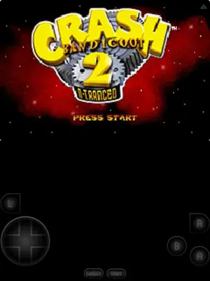

Here are some screenshots of using the direct from storage device method for playing ROMs (tap the picture to see a larger view):

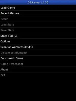

1) This is a picture of the interface of one of the emulators that supports this method. You see this screen when you open it afresh. This happens to be GBA.emu.

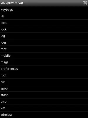

2) This is a picture of the "load game" menu. You should start out in this directory (/private/var/) when your loading a ROM with this method. You can see the "mnt" folder above "mobile".

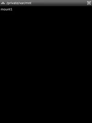

3) This is a picture of the "mnt" folder. As you see mount 1 is showing. This means you successfully connected your storage device.

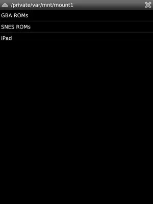

4) This is a picture of "mount 1" opened. In my case it's the contents of a 2GB flash drive that has GBA and SNES ROMs on it, along with some backup system files.

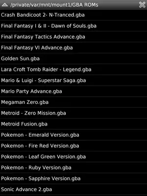

5) Since we're using GBA.emu this is a picture of the GBA ROMs folder opened. As you can see there is a list of all my GBA ROMs.

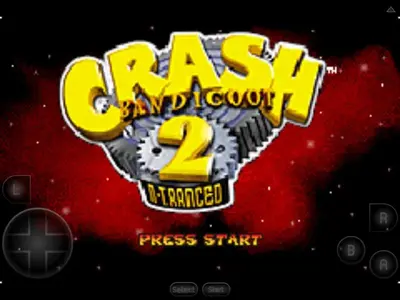

6) I picked the first game, which was Crash Bandicoot 2: N-tranced. This is a picture showing that it successfully loaded. This is in the portrait orientation mode. You can see the controls in the bottom half of the screen.
7) Finally this is a picture of the landscape orientation mode of the loaded ROM. This is the suggested orientation mode for using this method because it's less probable you will accidentally detach the storage device. (at least if your using a small sized device. I recommend using an SD card for this method.)
