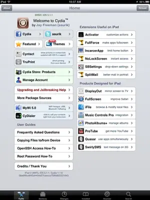

Yes doing the dfu restore worked like a charm. Proof is in the picture.
