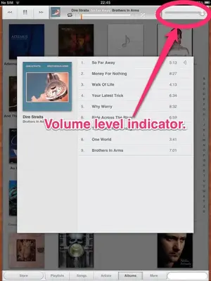

OK. With music playing what happens to the slider in the music app when you adjust the sound with the up and down buttons?
For now I'm not too interested in whether you have sound or not. I want to see if your iPad is responding as it should in other ways. Just press play and see if the slider moves.
When I push play it does not show the circle on the volume indicator. It just has a line a cross

That could work, but I'm worried about the lack of a button in the volume slider. I haven't been able to reproduce this.
I'll be back online in a few hours, and I'll put some more thought into this. I can't see how it can be a hardware problem, but it might be.
