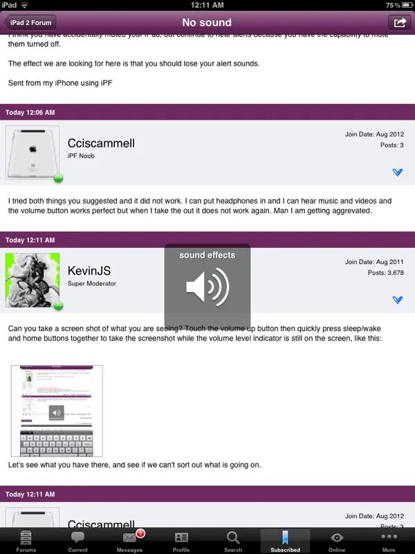

I tried both things you suggested and it did not work. I can put headphones in and I can hear music and videos and the volume button works perfect but when I take the out it does not work again. Man I am getting aggrevated.
Can you take a screen shot of what you are seeing? Touch the volume up button then quickly press sleep/wake and home buttons together to take the screenshot while the volume level indicator is still on the screen, like this:
Let's see what you have there, and see if we can't sort out what is going on.

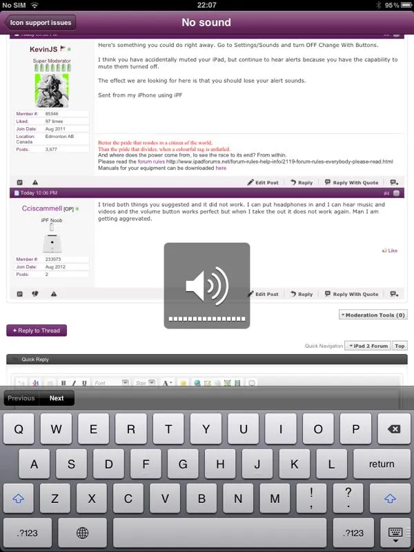

OK. For the first time ever, I have the sound effects volume available to me by turning on the Change with Buttons setting.
However, leaving this control on does not affect my ability to control the volume of music played through the speaker. When I run the Music app and adjust the sound, the sound effects control is replaced by the speaker volume one, and when I turn it off, the sound effects control is back.
Now we just have to find what is stopping your audio volume from appearing.
Best place to start, I think, is to turn off the Change with Buttons capability in Settings/Sounds. Then we will lose the sound effects volume control and can concentrate on the other stuff.
