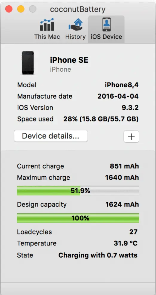

For an iPad device of that age, the battery may be the issue despite recharging on AC - I would suggest that you download Coconut Battery - open the app on your computer w/ the iPad cabled - then click the iOS Device tab (see the screen capture from the link) - this will provide useful information on the charge cycles and the 'battery health) - in general, an iPad battery after 500 or more 'complete cycles' should maintain about 80% of its original capacity - if your load cycle is a lot more and if your 'battery health' is LOW, then that may be the issue - you're likely dealing w/ an antique device and should probably consider obtaining a newer model. Dave :)

Thank you. I bought a standard female to male y cable with male to male cables going to the pc and AC adapter, but I am not sure it will work. I will try the powered USB hub. Thank you!
