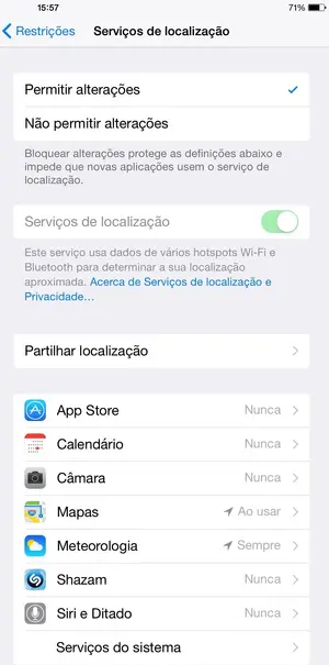

Now that Maps is working fine I noticed the following:
Privacy - Button Location Service is ON though, it is blocked (soft green and can't chance it).
Privacy - Share Location is OFF and also blocked (white and can't chance it either).
Tried over and over again and can't find how to unblock.
Hope someone may help me get this right. Thank you.

I'm going to take the screen shot ( my 1st!)
Sorry, what do you mean on restrictions settings?
1st is Privacy settings Location Services (you can se it is ON but I can't chance it because - I don't know how - it is blocked, even the green color is different
2nd is Share Location which is also blocked (it doesn't move to green) , is OFF on this case - if I want to Share my Location with some Family I can't chance the settings.

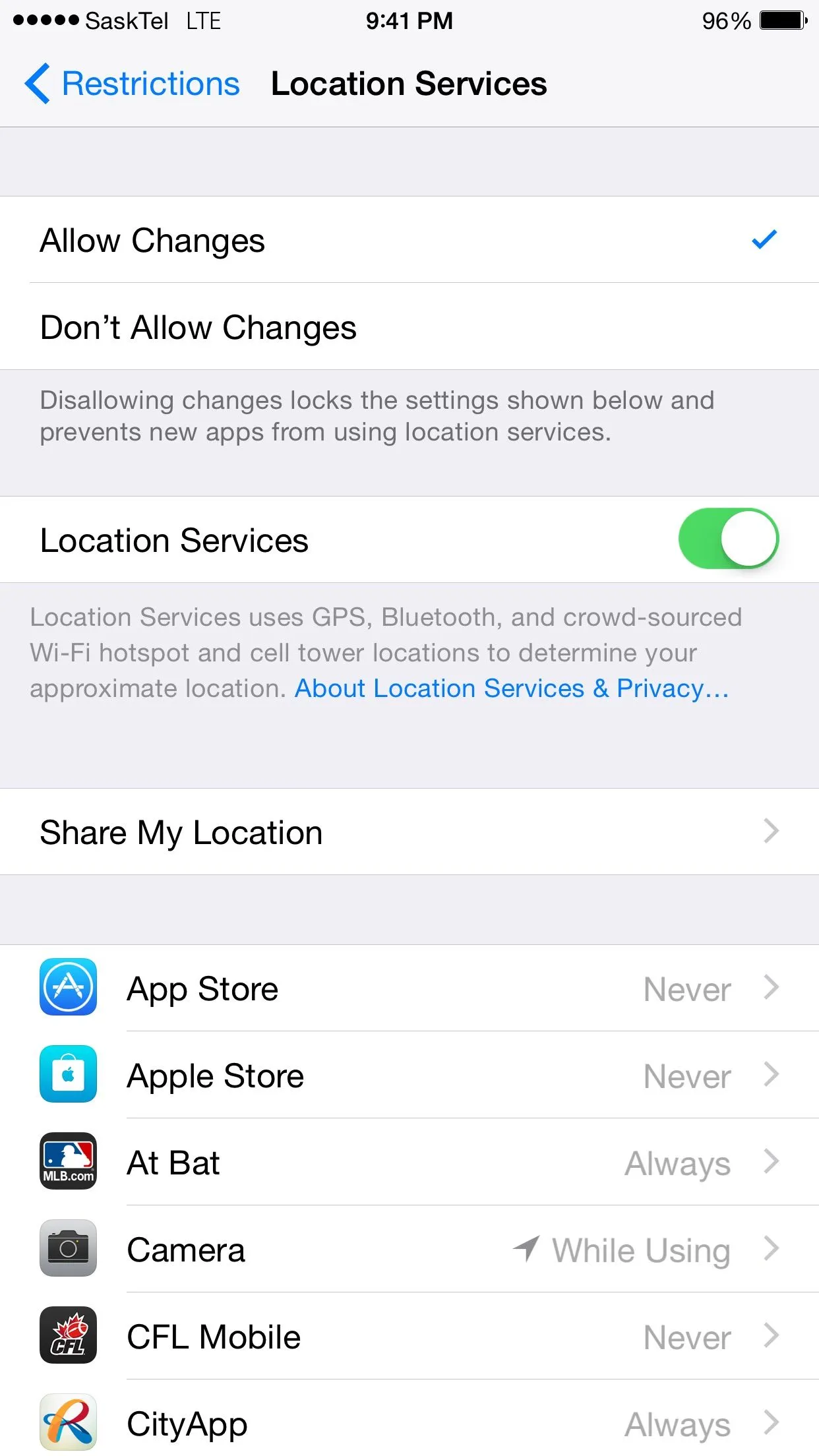

If you already have a restrictions password set, make sure that you have chosen to allow changes in location settings. If you've checked off don't allow changes you'll not be able to change the settings. Here's a screenshot of the page in location settings with the switch set to allow changes.
Do you have a restrictions password set? Unless you set a restrictions password you cannot change anything in the restrictions category, including Location Services. Try setting a restrictions password if you have not already done so, then let us know if it makes a difference.
If you already have a restrictions password set, make sure that you have chosen to allow changes in location settings. If you've checked off don't allow changes you'll not be able to change the settings. Here's a screenshot of the page in location settings with the switch set to allow changes.View attachment 61898
General - Restrictions - Yes - password is set :
Privacy : location services: allow changes is checked - Location Services (under) is set green but can't change it.
The option Share Location is off and can't change it.
