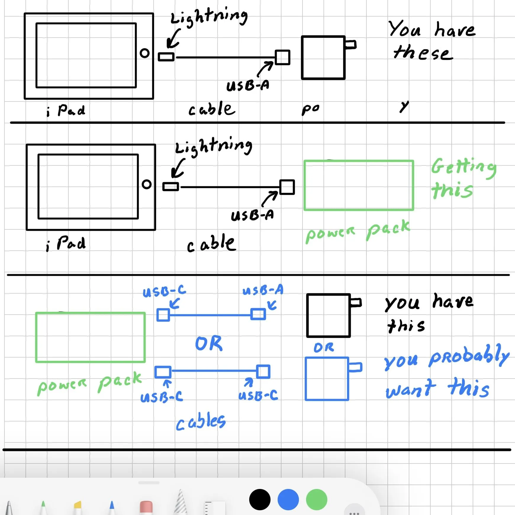

Ok, lets see if we can simplify this a bit.
We'll specify a power pack with at least 20,000 mAH, at least one USB-A port for powering the iPad, and a USB-C port for charging the power pack. The vast majority of power packs that are usable for larger devices have USB-C as an option to charge. More ports are fine, good even.
Drawing 1: This is what you currently have.
Drawing 2: You need absolutely nothing new to plug the power pack into the device. You have it all, except the power pack specified above. You might want a second Lighting to USB-A cable, so you don't have to unplug it from the iPad's charger every time you go out to the shed.
Drawing 3: Option 1: You can use your current iPad power supply to charge the power pack. You'll need a USB-A to USB-C cable to do this. There a few power packs that can use a Lightning port to charge, but they are mostly for iPhones with less than 20,000 mAH capacity. If you hunt down one of these and use it you won't need a new cable, but I don't recommend it for reasons I'll mention later.
Drawing 3: Option 2: You get a new power supply with a USB-C port and a USB-C to USB-C cable to charge the power pack. It needs to be at least 15W. Bigger will charge the device faster, up to a point.
I recommend the 2nd option for several reasons.
1. A second power supply will let you charge your iPad and power pack at the same time.
2. Both the USB-C power supply and USB-C to USB-C cable will likely come in handy down the road when/if you upgrade your iPad, or purchase other, newer devices. (but not the iPhone, yet).
3. With the addition of a Lightning to USB-C cable, you can use the second power supply as a backup for the iPad.
None of these cables need to be expensive. $10 to $15 dollars is about right. An ok power supply should run around $25 to $50 dollars. Much cheaper and you risk getting less safe knockoffs. More expensive is a waste of money for your purposes.
Keep in mind I'm leaving out a lot of options that might be the perfect fit, but this should be good enough.
Fantastic twerppoet. Hugely helpful, for an idiot such as I am. So I have a usb-A cable then already. Understood. So I guess it's a lottery as to whether the power pack has a usb-A port then. Most seem to be usb-C's. Which leaves me wondering if that means it's not compatible, or yes if I buy a different lead, or yes if I buy a usb-A to usb-C adaptor.
So still some guessing to do buying a power pack. Even if it might say ipad compatible, would an adaptor actually work: a rhetorical Q, as Ive used adaptors before in digital cameras into ipad & didn't work.
So I'll scour about to find one - with- a charge cable included. Now I know these do exist. Then just see what happens trying to plug a into b into c & go from there. I'll report back once I've actually got one. I'll definitely get a 20,000mah at your advice.
Thanks really appreciate the diagrams. SDDoodle

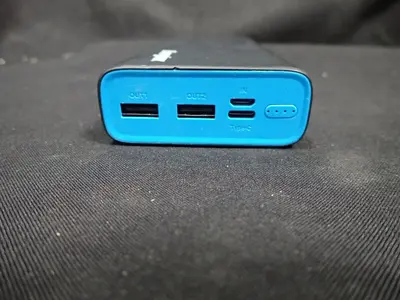

Hi chaps. Just got the power pack. It comes with a " type C to usb " cable.
Usefully it's the same type as the blue end photo above.
Assuming the type C smaller end goes into the IN side of things. And assuming the 4 tiny dots might be charging indicators..
Can someone tell me: where is the actual charger? There must be a charger, of some form, to get charge into it. It cannot be within the lead.
Thanks, SDD

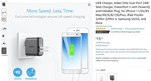

Hi again - please provide the brand and model (or an uploaded pic or link) - might help us understand the one you purchased - I own a half dozen different chargers (accumulated over 10+ years) - one that I carry on the road is shown below, i.e. AC receptacle and 2 USB-A plug-ins - that is the type of charger you need and may already have in your collection, e.g. the one used to charge your iPad? Plus, TP in his diagrams pictured a charger - now you simply connect the appropriate cable - from your description the USB-A end goes into the charger and the USB-C end plugs to the 'IN' port of your battery pack. Dave :)
P.S. I also own chargers w/ a USB-C and 'fast charge' technology - use one for my iPad Pro (which has a USB-C port) - in that instance, the cable has USB-C connectors on each end.
No problem.

@giradman
forgive me, but your picture eg above is not of use. Its a completely different scenario. This is the confusion. This is the difference.
Your pic above is as my per my list of prior battery-driven eg's ( nokia phone, builders led light). There are two bits of hardware. A device, & a charger. Here, is your iphone, with it's separate charger. My ipad is the same.
Ok. Your iphone eg above came with a charger. My ipad did too. Why your pic above shows an aftermarket charger, I think, is n/ a. It might as well just show my ipad with its charger plug. Unless Im mistaken.

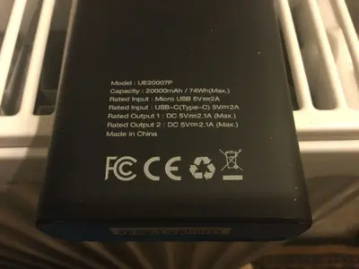

@giradman I have an energizer 20,000mah battery pack. It is the same photo as I put up before. It came with a short usb to mini C cable. I have no idea what kind of usb cable end it is.
The inputs seem to need 5v, 2A. The small lead end fits the larger input port.
The outputs 5v, 2.1A. I have no idea what usb type of ports they are ( 2 of).
I have no idea if this is compatible with my iPad, I had to take a chance it would be, but so much info & I was so confused tbh I was overwhelmed.
Thanks, SDD

A so called charger is really only a device for adapting high voltage AC current to a lower DC current that your iPad or other device can take on board and store power in its lithium battery. The iPad technically does the charging and has it’s own regulator. So, all you need to charge your battery pack is the so called iPad, or other adaptor/charger.
Hi jupiter, thanks that makes more sense. But surely, if my ipad is so fussy about what " plug/ charger " or whatever on earth the big white plug thing that comes with it is... then other things will be similarly fussy.
The one thing that seems to need matching, the fussy bit, is the 2A rating. But I have not enough knowledge to understand current, so cannot evaluate what is specifically needed ( if it does need something specific) connected to this battery thing to charge it.
It is important not to exceed the Voltage required, ie 5 Volts. The device will usually only use the Amps it needs. There should be advice in the instructions as to the maximum if there is a limit.
