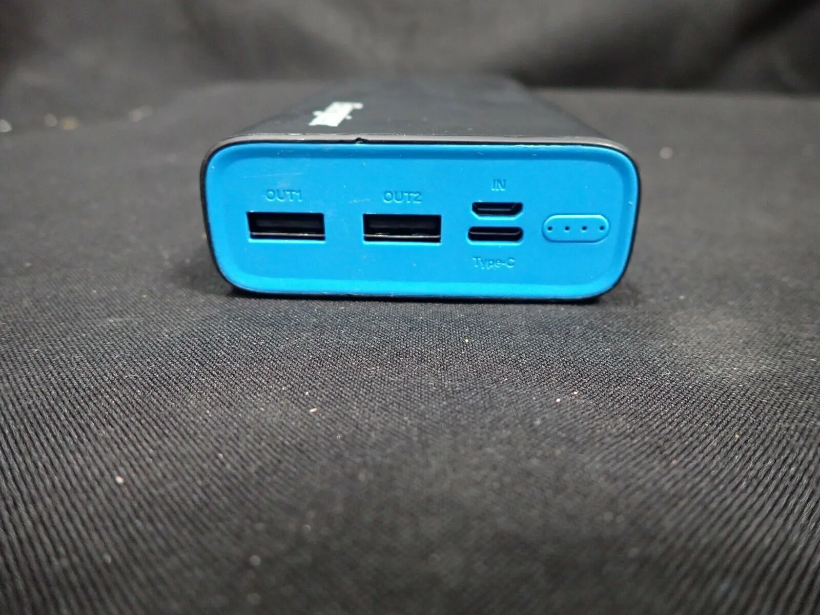

Actually twerppoet Im a bit confused by these.
Ive seen both the 20k mah Anker ones ( £45 fairly costly), & medium quality 20k mah ones about £25 To £30. And all crappy ones Im steering clear of.
Ok so I see these have usb-A outputs. And other smaller usb-C "in" ports.
Similar to this photo.
So, does the ipad have a usb-A compatible lead? Im assuming my charger lead can be used, with its usb end ( a,b,c ? god knows) so I dont have to buy a separate lead. Is this correct? will this lead be compatible?
The other thing is.. what the principle is here. I understand its a powerbank, providing a beefier battery to power the ipad, &/ or, if the ipad is low on battery, it can be used to - recharge- it. So two functions. Afaict. I only need it for the first, as Im not roaming around, Im fixed in my shed, always.
But what happens when the power bank itself runs low? This is the thing I can't understand. If there was a charger coming with these mini monolith things.. I could get my head around the idea. But they don't. But some photos show them sitting in " docks" presumably themselves, charging.
So what is the principle idea with these?

To use the power pack, you can use the same power cord that you use to charge your iPad now.
The unit in your picture would be charged using the IN ports. You could use the same power supply you charge the iPad with, but that might get awkward if you need to charge both at the same time.
Picking up another power supply is not a bad idea. You would have a spare for the iPad as well as one for the power pack. If the power supply is going to be backup for your iPad charger, you'll want one with a USB-A port. It should also supply at least 15 Watts, or say it is for the iPad on the package.
To charge the power pack you'll also need a USB-A to USB-mini or USB-C port. The two ports shown under IN. If you don't already have this unit you could look for one that will charge on a USB-A port.
I recommend the USB-A to USB-C cable as an option, since you are likely to run into this port eventually anyway. Most computers and devices are moving to it. Make sure the cable says it is for charging, and don't be fooled by the Thunderbolt cables that looke exactly the same. They are more expensive, and you don't need it for this purpose.

Hi twerppoet.
When you say the unit in my pic 'would be charged using the IN port' this is the bit Im confused about. Ie. What on earth... goes into the IN port.
This can only surely imply one of two things: whatever gets plugged in here must be either 1) a plug from the mains, or 2) a plug from somewhere else.
If a mains lead... where are they? If something else... what?
Each of these 20k mah battery packs, regardless of price, is a single unit. £45 for a single unit. There is no mains lead, or any other cable, or another bit of hardware with it that I'd expect there to be... if... this thing needs " to be charged ". But I dont know if this thing "needs to be charged". All I can do is assume so, because it is a battery thing.
If I cannot understand this, Im far away from determining/ understanding what possible lead can connect a to b.. (or to c, if c is relevant).

The battery packs charge just like your iPad, using a power supply (charger) and cable. They rarely come with either. The assumption is that you will use the same charger and cable as your device.
In the case of an iPad with the Lightning port you need a different cable, but can use the same charger. Or you can buy another charger so that you can plug your iPad and power pack in at the same time.
Since it is a power pack, the only thing IN can mean is power in, for charging the device. The pack shown offers two kinds of ports. One is USB Mini, the other is USB-C. Some packs, like mine, use the same port for both charging and powering your device. This is more common than the one you showed. At least here in the US. I've never seen a dedicated charge port before, nor one using a USB-Mini port. Must be an Android thing.
If in doubt, I recommend you go to a nearby store that sells them, and get some help. Bring your iPad so they can be sure you get what you need.

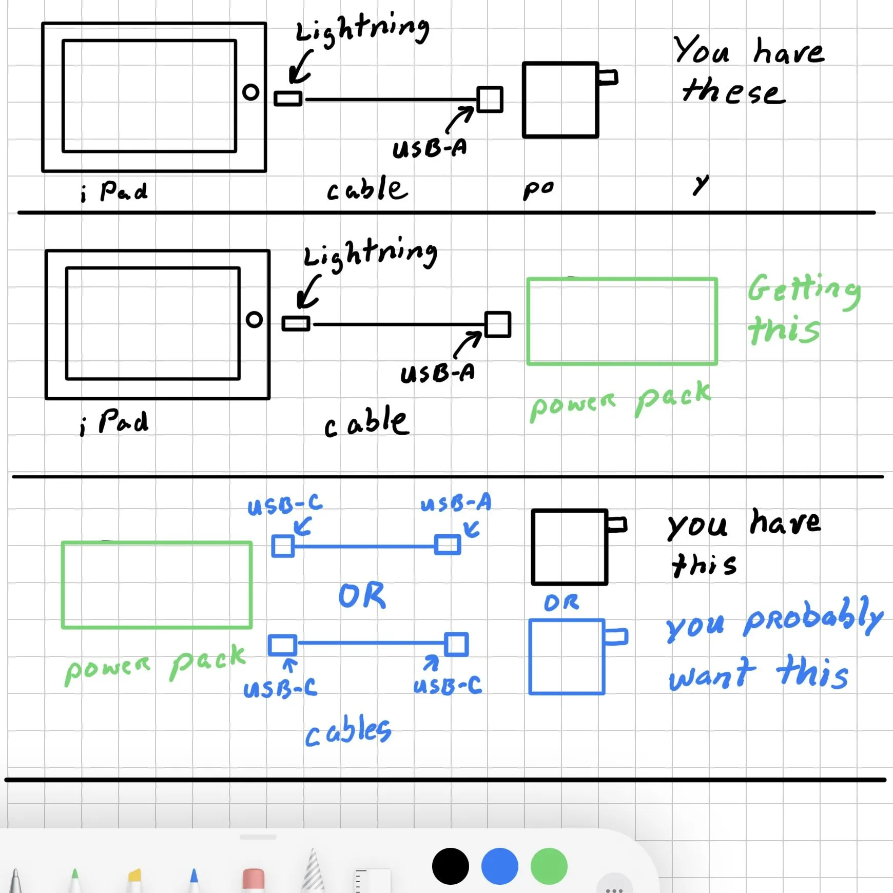

Ok, lets see if we can simplify this a bit.
We'll specify a power pack with at least 20,000 mAH, at least one USB-A port for powering the iPad, and a USB-C port for charging the power pack. The vast majority of power packs that are usable for larger devices have USB-C as an option to charge. More ports are fine, good even.
Drawing 1: This is what you currently have.
Drawing 2: You need absolutely nothing new to plug the power pack into the device. You have it all, except the power pack specified above. You might want a second Lighting to USB-A cable, so you don't have to unplug it from the iPad's charger every time you go out to the shed.
Drawing 3: Option 1: You can use your current iPad power supply to charge the power pack. You'll need a USB-A to USB-C cable to do this. There a few power packs that can use a Lightning port to charge, but they are mostly for iPhones with less than 20,000 mAH capacity. If you hunt down one of these and use it you won't need a new cable, but I don't recommend it for reasons I'll mention later.
Drawing 3: Option 2: You get a new power supply with a USB-C port and a USB-C to USB-C cable to charge the power pack. It needs to be at least 15W. Bigger will charge the device faster, up to a point.
I recommend the 2nd option for several reasons.
1. A second power supply will let you charge your iPad and power pack at the same time.
2. Both the USB-C power supply and USB-C to USB-C cable will likely come in handy down the road when/if you upgrade your iPad, or purchase other, newer devices. (but not the iPhone, yet).
3. With the addition of a Lightning to USB-C cable, you can use the second power supply as a backup for the iPad.
None of these cables need to be expensive. $10 to $15 dollars is about right. An ok power supply should run around $25 to $50 dollars. Much cheaper and you risk getting less safe knockoffs. More expensive is a waste of money for your purposes.
Keep in mind I'm leaving out a lot of options that might be the perfect fit, but this should be good enough.
