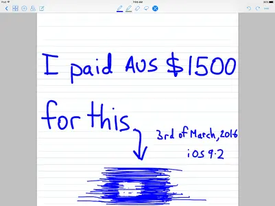

Last week I bought a 12-inch iPad Pro, the third iPad I have bought since 2010. I have just become aware of this appalling non-responsive area next to the middle of the right edge of the screen (portrait mode).
I do all my writing at the bottom of the screen (landscape mode) so that my wrist can be supported by the bezel. To avoid the non-responsive patch I now have to turn the device upside-down. This makes it difficult to access the volume controls (something I'm coming to realise I do frequently), but much more inconveniently, I can no longer access the AV port in the wall of the classroom I teach in without purchasing some sort of extension lead and having the wire snaking all over the place waiting for people to trip over it or walk all over it.
Apparently this problem doesn't exist for users of the Apple Pencil. For a number of reasons, I don't want that thing. Nor do I need it, or so I thought. I spent AUS$1500 for this device, it should work properly.
I am on iOS 9.2, my device is wifi-only. Does anyone know if this issue has been resolved in 9.3? Does anyone know if the iPad Pro 9 incher is similarly flawed?

I'm on iOS 9.3.1. Still there, though it seems to be a bit less sensitve. I still can't make it happen with my finger like iheartapple could, but my smaller stylus shows it if I press lightly. Pressing firmly looks more like uisng my finger.
Here's my previous test
Test with by big fat finger.
Test while pressing lightly with a cheap targus stylus
All tests using the Notes app.

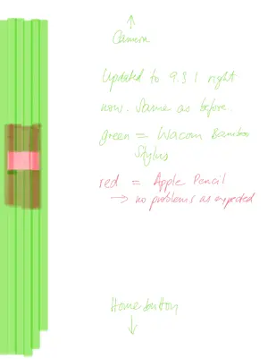

@chowdown: Just updated to 9.3.1. Still the same. I find it quite interesting, that you have the issue with a wifi-only IPP. As you may have read, I tried several demo objects in several shops here in Germany, and apparently only the wifi+cellular models had the problem. All the wifi-only models worked quite fine. I brought my own Wacom Bamboo stylus with me every time I tried one of the demos… As twerppoet suggested: You should consider an Apple Pencil, it is really quite a difference. BUT I understand you fully, I am quite angry as well, as I expect for a device of this price tag to work flawlessly, regardless of the preferred use of the owner. It is my free will to use a passive stylus, my finger or what else. As I actually love the Pencil, I tend to accept the status-quo. Frankly, I did not believe that this was/is a software issue, being solved by an update, as the senior advisor told me. Until now, I am right. :rolleyes:
