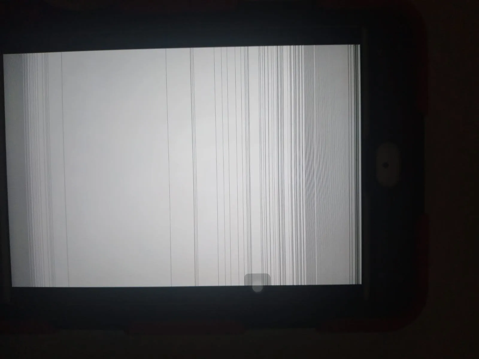

Grey blurry lines, appear and slowly expanded, software/LCD or motherboard problem? 3 Opaque black ones now started, Ipad mini 4
hello1
Oct 2, 2021
4
The lines started appearing out of nowhere, no hits, no water damage.
At first it was only one line, the 2 and so on... Then they began in the other side of the screen.
Now some months later opaque lines have started
I know that in this model LCD and touchscreen are jointed, wonder if a replace will fix it.
I think it is a 2016 model, received it as a gift, and months later lines started.

To me that looks like a failing logic board.
Btw, I should also explain, it isn´t white all the time, I chose that as background so you guys coul see all the lines. Do you still think that is the problem?

Almost certainly a screen problem. Either the LCD panel, or the backlighting. Not sure about the second one, since I don’t remember how the backlighting was done in that model. It is not impossible for it to be graphics driver issue.
The appointment with Apple is a good idea to pinpoint the issue. It is extremely unlikely that thier repair cost (if available) will be a better choice than buying a new iPad. The base models are actually cheaper than the one you own when it was new.
Self repair is, of course, an option. However no matter how much cheaper it is than a professional repair, it’s a complete waste of money if it does not work. Any video or tutorial that tells you it’s easy is lying to you. If you are not used to repairing sensitive electronics it’s gong to be challenging. You’ll need patience, careful preparation, and attention to detail. Also a trusted source for the parts.
I’m not telling you not to do it. It can also be fun and satisfying. Just don’t go into it with the expectation that it’s a guaranteed win.
