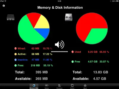

NYHorsewoman said:
Hmm, I just downloaded that but I don't see where it shows you RAM.
It is the left pie chart in the Memory & Disc tab, or top if you are in portrait view.
Hmmm, no pie chart for me. Wondering if I downloaded a different version or app??
