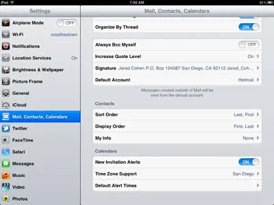

My calendar has inexplicably lost the add event button... I cannot add events, and when I try to add an event by selecting an underlined date in an email (usually opens up the calendar and creates an event) I receive an error message: Cannot Save Event - No Calendar Has Been Set. Does this mean anything to anyone? Are we supposed to rely exclusively on the reminders now?

For the second problem, try going to Settings > Mail, Contacts, Calendars, the Calendar section and select a default calendar. That will probably fix the not Calendar has been set problem. It might fix the first one too. If it does not, try these more general solutions.

Thanks for the reply... I don't seem to have the option of selecting a calendar, though....
Close, reset, reboot, didn't seem to change anything. Very weird. Not sure when it happened, because I haven't used the calendar in a couple days... Maybe tied to the iOS5 update?
I miss my add event button.... :)

Goto settings - icloud and switch calendar syncing on, you may also want to check your contacts, if you also don't have a add button in contacts you need to do the same for contacts syncing.

Turning iCloud for calendar on and off seemed to work... Thanks!
