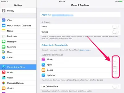

I can answer your first question. In iOS 7 automatic app updates are turned on by default. To turn them off go to Settings>iTunes & App Store and make sure these switches are turned off.
I see Scifan has now shown you how to turn off Automatic updates which were introduced with an earlier iPad update.......you will now see all of your updates come through and be able to update them when you like.

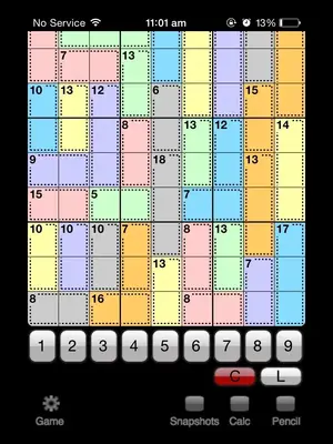

image.webpThank you very much for your replies. Much appreciated.
I had already done a restart and a reset but the problems still exist. Thanks for telling me where to turn off automatic updates. Also how to delete all the apps that were still showing as open. That has changed and I didn't know how to do it.
I went into the apps page to view all the apps I have downloaded. Some free and many purchased. The three apps that are having the display problem do not show on my list of purchased apps though all are most definitely purchased. It is strange that it is these ones that don't even show on the apps purchased lists are the ones with the black border around the edge.
I have deleted and downloaded theses apps again. They acknowledge that I have purchased them so I don't have to pay again. But they still don't show on the apps list and they still have a display problem. I have hopefully attached a screengrab so you can see what I mean.

Thanks for the Screen shot......that looks like the same issue with the app I'm having trouble with also......before I didn't have the wifi icon and time showing when in this app and now it shows and covers what I need to see.

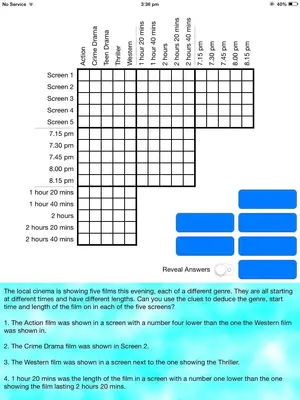

I have attached another screen grab of a problem app. I do believe this is the one that should be fixed but I have no way of communicating with this developer and am just assuming they are fixing from what I have read on a comment page. The solid blue bars at the side of the puzzle all have instructions which can't be read. And the blue over the clues at the bottom keeps changing from the correct position you see here to running vertical at the side of the puzzle.
I can't find anywhere if there is a way to change the display on the previous screen grab sample game. I will check the App Store and see if they are supported by the latest iOS 7.

<img src="http://www.ipadforums.net/attachment.php?attachmentid=54380"/> I have attached another screen grab of a problem app. I do believe this is the one that should be fixed but I have no way of communicating with this developer and am just assuming they are fixing from what I have read on a comment page. The solid blue bars at the side of the puzzle all have instructions which can't be read. And the blue over the clues at the bottom keeps changing from the correct position you see here to running vertical at the side of the puzzle. I can't find anywhere if there is a way to change the display on the previous screen grab sample game. I will check the App Store and see if they are supported by the latest iOS 7. Thanks again Caro

Hmm. They are all iPhone apps running in emulator mode on your iPad; which explains the poor graphics quality.
I'm a bit confused though. There should be a x1 in a circle at the top right of the screen, so that you can shrink down the app to normal iPhone size. If it were there that would be the simplest way of getting around your problem. I'm wondering if that's gone away with the iPad 2, now that almost all iPhone apps are retina.
Anyway,
Logic Puzzles and Killer Sudoku were last updated in 2008. Logic Puzzles 2 was last updated in 2012.
The problem is that the apps were designed to hide the status bar at the top, but iOS has updated how the status bar works, and the developers have not bothered to update their apps to reflect this; so now it covers just a tiny bit of each app at the top.
There is no fix that I can think of that doesn't involve the developers updating their apps. Given that they have not updated their apps for over a year, or longer, I'm not hopeful that they care enough to do so.
