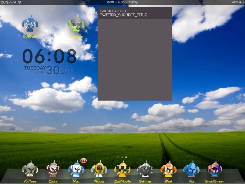

1. Simplescreen - simple date/time widget
2. Twitter feed - don't have a twitter account so I can't test....
Twitter widget setup:
1. Sign into twitter
2. Create a list of everyone you want to show up on the twitter feed.
3. Open the Widget.html file with the text editor of your choice.
4. Replace TWITTER_USER_NAME with your twitter user name
5. Replace TWITTER_LIST_NAME with your twitter list name.
6. Replace TWITTER_FEED_TITLE and TWITTER_SUBJECT_TITLE to the names of your liking.
optional:
by changing the color key (obtainable through google, gimp, or photoshop) you can customize the color combinations.
I did not create these but props to who did....
