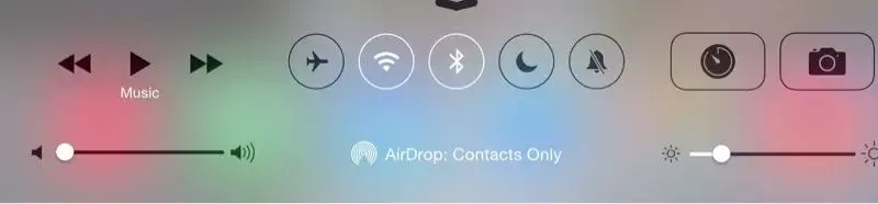

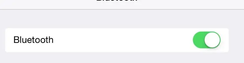

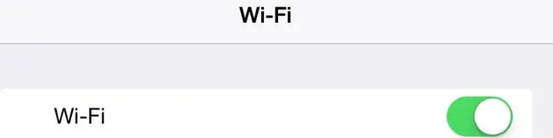

Ok, we restarted our wireless router and I now have my AirDrop. Then it disappeared. Now I don't get the Airdrop icon. We have turned Bluetooth on and off. Turned wifi on and off. Sometimes I have it, sometimes I don't. The mini can't even be discovered when it works and that was updated, also. The phone can be discovered when AirDrop is working on the AirPad. The AirPad can be discovered on the phone when it is working on the AirPad. The Mini is not discovered on any device and that was update. The iPhine 5 is not updated and I don't think I ever will update it. Can anyone help me with this? I thought I had it with restarting the router, but, alas, no. Thanks. I have attached screenshot photos from my iPad Air.
