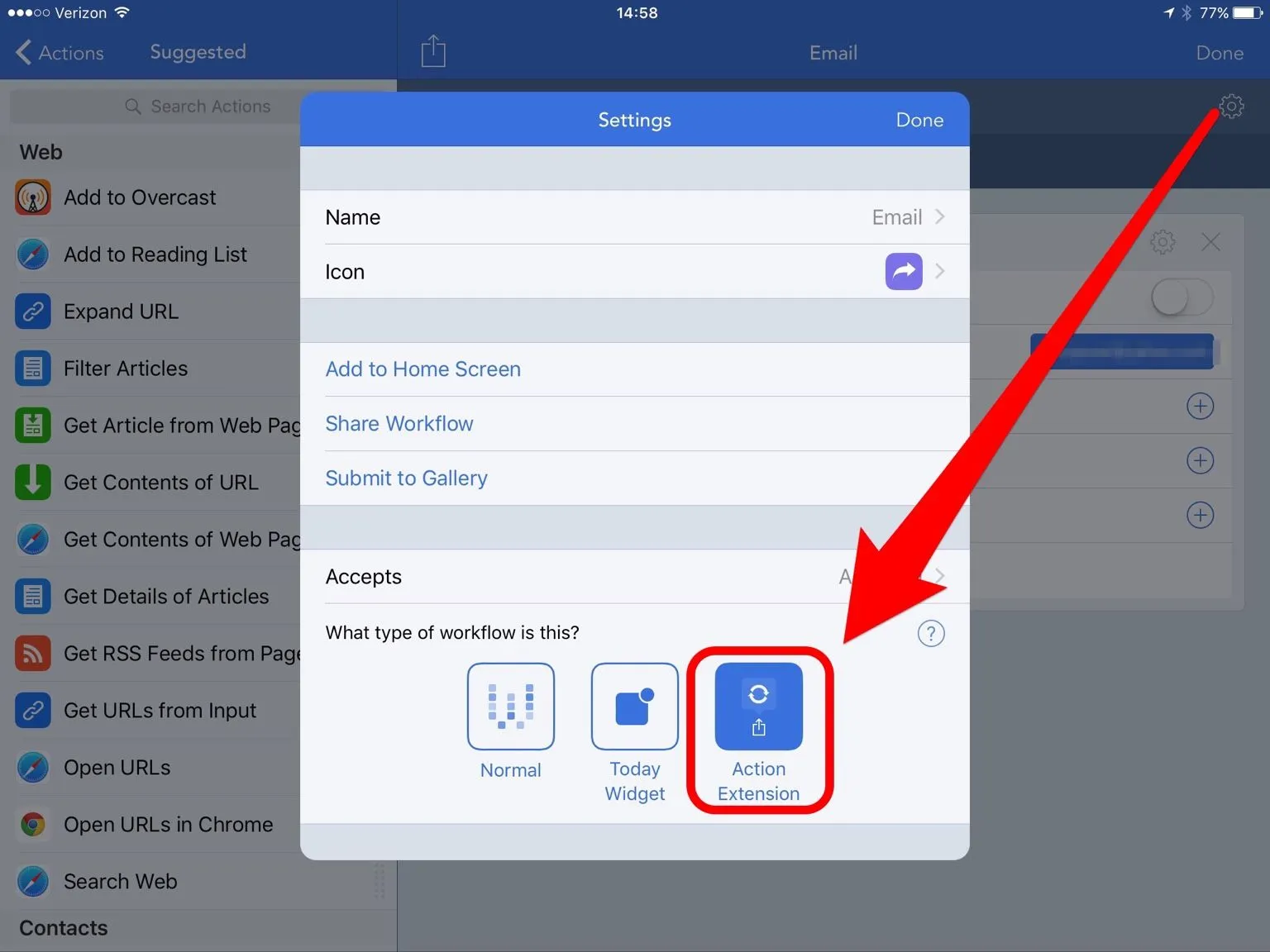

When you are editing the workflow tap the gear/settings icon near the top right. make sure you have Action Extension option selected. You can also restrict what kind of input the workflow accepts. I rarely do this last part.

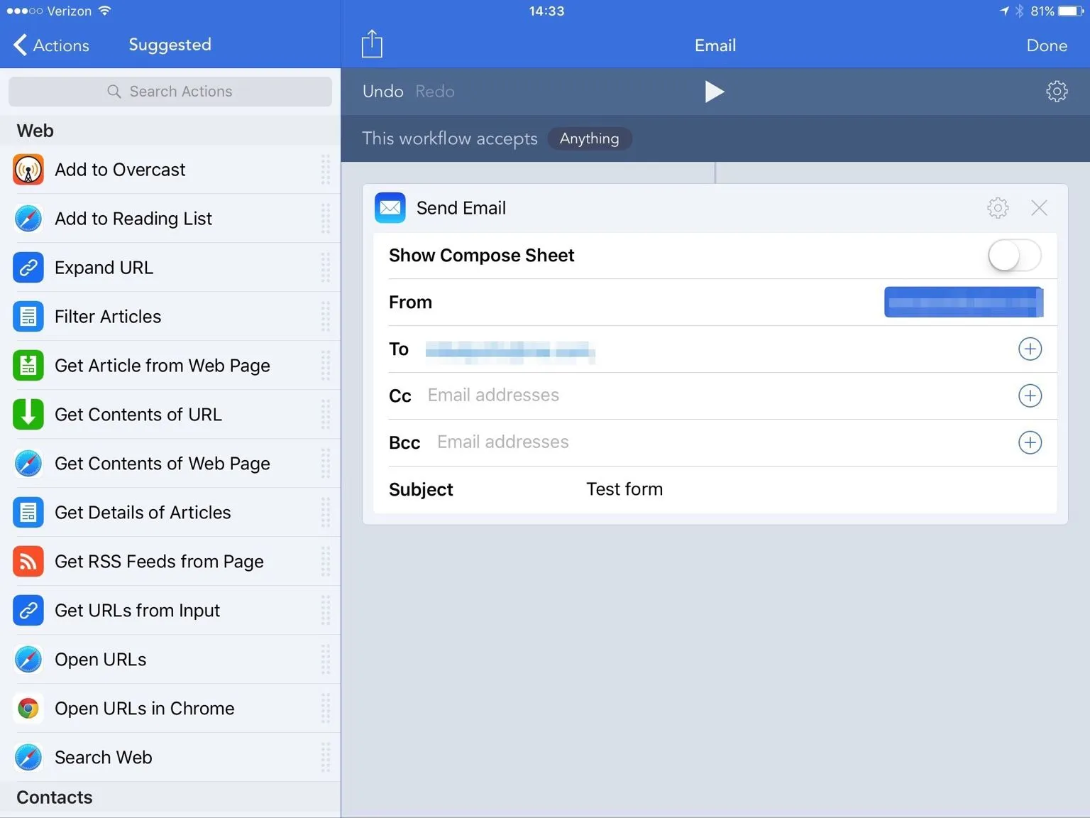

The only action in your workflow should be the Send Email action. Type in the address fields and the Subject. If you want the email to be sent immediately without intervention, be sure to turn off the Show Compose Sheet switch. It will ask you to provide the email address and password for the account you want to use to send. This is where I ran into trouble with the two-step verification.

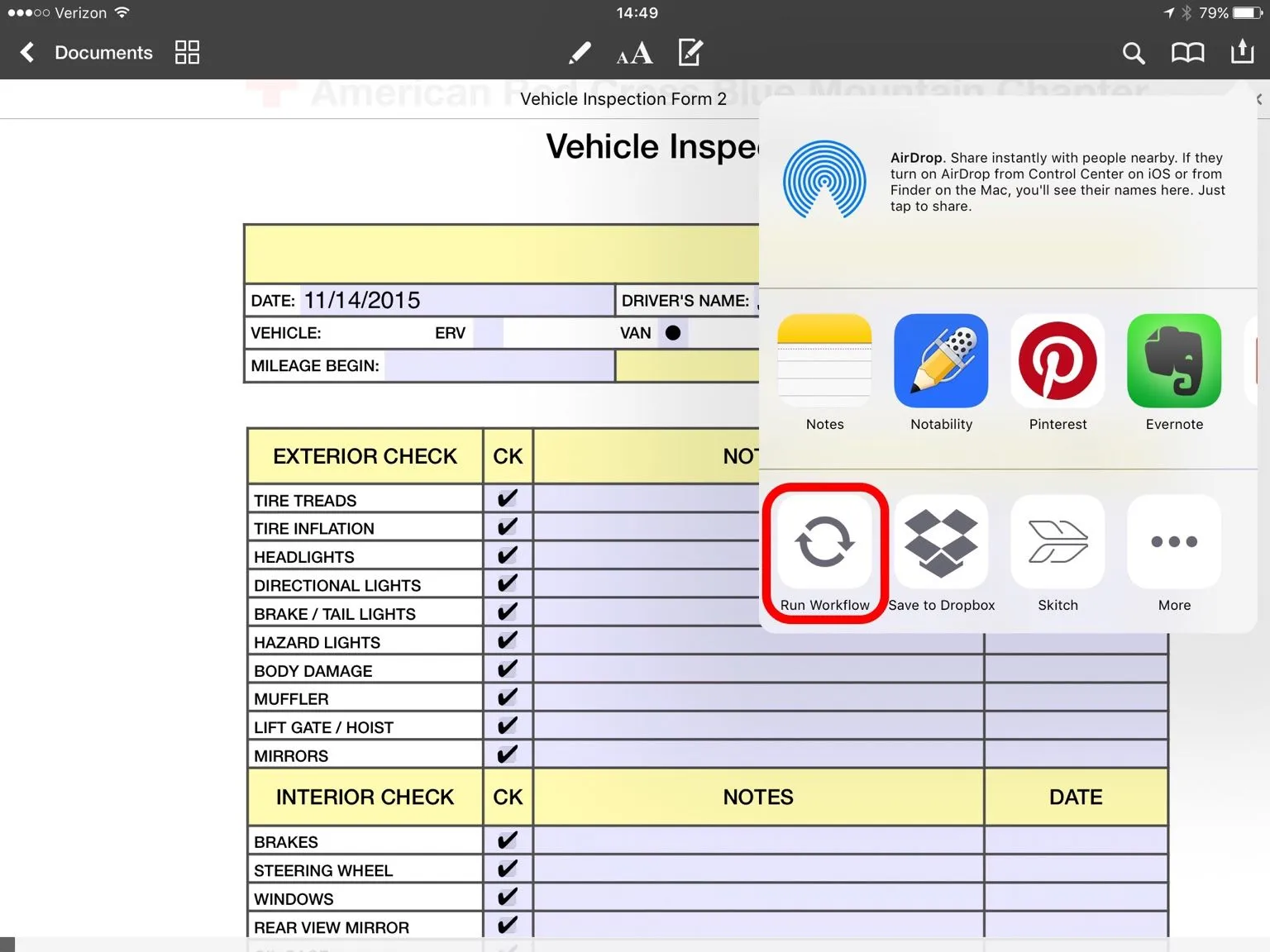

In PDF Expert, when you are ready to send the form, use the share icon (box with up arrow) and choose the Open In option. You'll get another chance to flatten the document, if you haven't done so already. Then it will show you the Share Sheet.
In the bottom set of gray icons, slide over until you see the More option. Use it to turn on Workflow (you won't have to do this again).

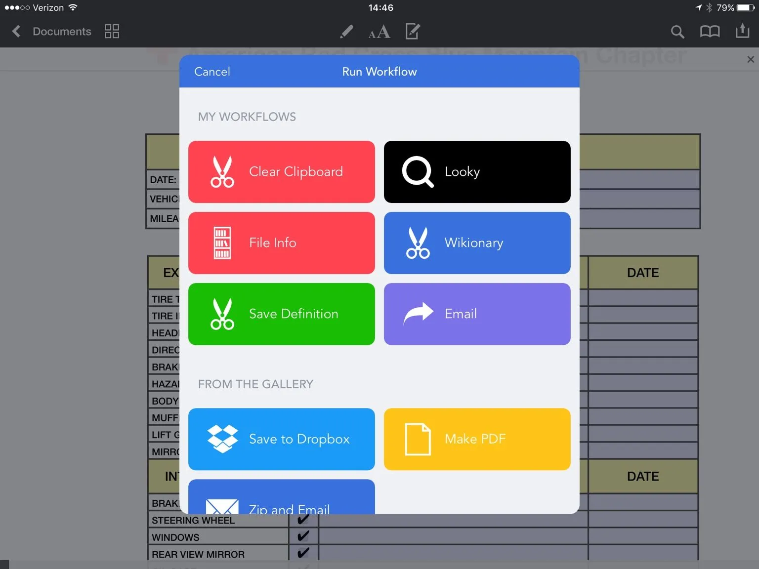

Now choose the Run Workflow icon. Tap on the workflow you saved. (If you failed to choose Action Extension in the workflow's options, it will not show up here)

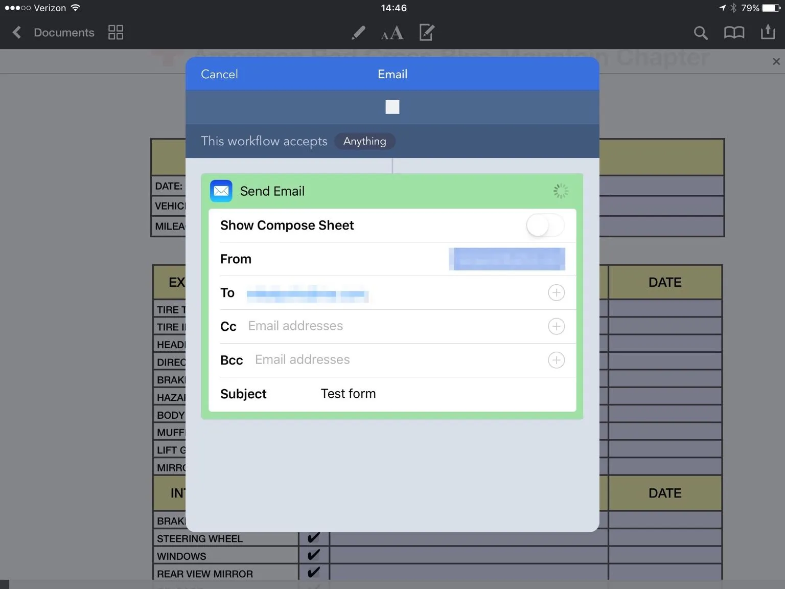

The workflow will spring into action, showing you the steps as it does them. If you left Show Compose Sheet on, then it will populate the email address, subject line, add the attachment, then wait for you to tap Send. If you think you might want to add comments or adjust the subject line, this is the way to do it. If the Show Compose Sheet switch is off, then it will send the email, and close without any intervention (unless it asks you for your email address and password the first time)
