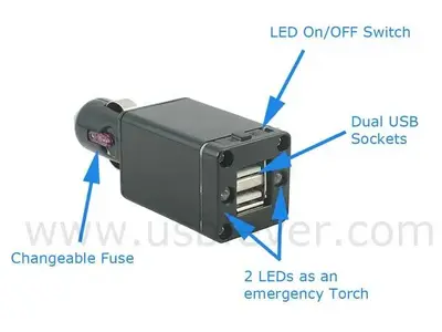

Well I guess the part I left out of my previous post was that almost all cars manufactured today, even European ones, run off of 12 volts and that is why I raised the question about using this charger. Ideally, you should look for something with a 12 volt input with a USB outlet that supplies at least 10 watts.
Drag Bunt
Jul 13, 2010
151
the 'burbs of @lanta
