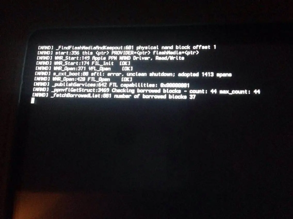

My daughter purchased a second hand IPAD and one morning noticed that it wouldn't turn on and showed as low battery even though it had been on charge overnight. I have tried restoring it via iTunes but it keeps erroring 4013 is the main one. I have attached a screen shot I get when I try and turn it on. Any help is greatly appreciated.

Thanks you I will try that tonight. Do you know what the information on the screen shot of my ipad actually means?

Maybe a hardware failure.
It could be caused by a damaged front facing camera, proximity sensor, compass or accelerometer IC, or the camera flex cable.
The Genius Bar at an Apple Store should be able to tell you what the info on your screenshot means.
