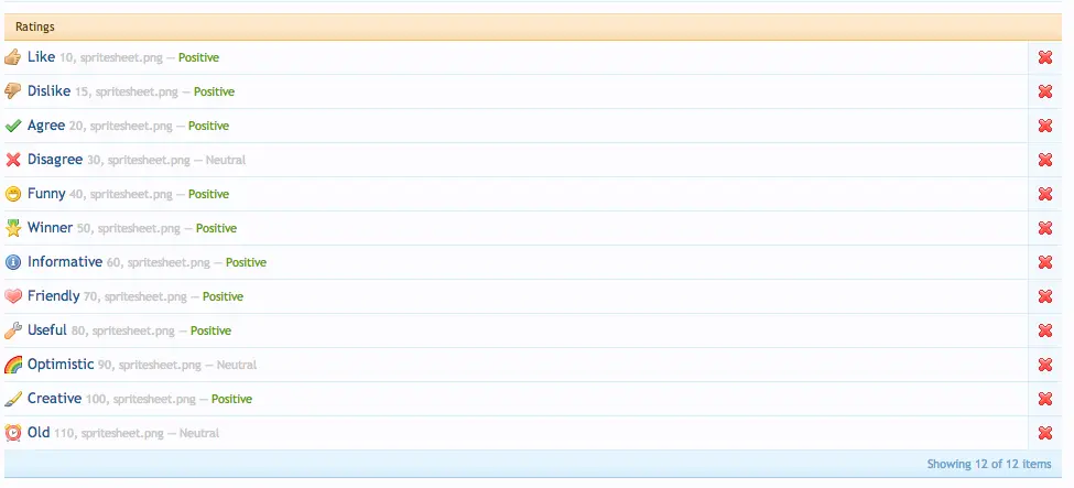

If you are on the computer, go to the post you want to thank and move your mouse pointer just under the Quote Reply buttons. You'll see a row of icons. Mouse over them to see what each one says. All are considered positive except Disagree, Optimistic, and Creative; which are considered neutral. I'm not sure why Dislike is positive. Strange.
On the iPad in Safari the icons are visible at all times, but there is no ready way to tell what they mean. However the first one, thumbs up, is Like, and always appropriate.
In the TapaTalk all all you can do is Like. Just tap on the post to get a popup menu with the option.
Here is a list of the rating and their meanings that I stole from another thread: With all thanks to the Admin who share it. Sorry not to remember the name.
