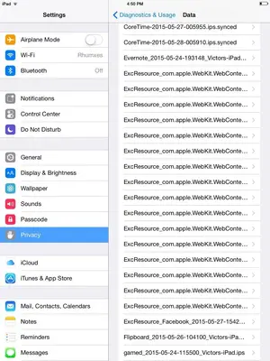

I tried deleting facebook and messenger, I tried removing my outlook account from my device yet I am still suffering from battery drain. I checked diagnostic and usage and I found this:
I've had hundreds of it and I don't know what it does. Can someone tell me what it is?
Battery Usage percentages only seems to show how much I use an app, it doesn't display background activites, at least that's how I see it safari still accounts for 70% to 80% of my battery usage, as usual.
