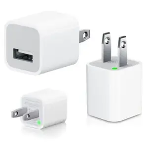

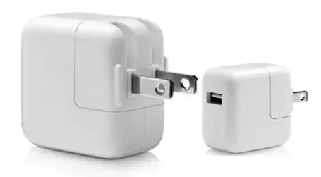

A question, are you using an iPhone charger adapter instead of an iPad charger adapter? The iPhone adapter is smaller than the iPad adapater.
Another thing I want to ask, where did you buy the chargers? I suspect its fake, you can find those almost everywhere. Try checking retail stores for real ones.
iPhone charger:
iPad charger
