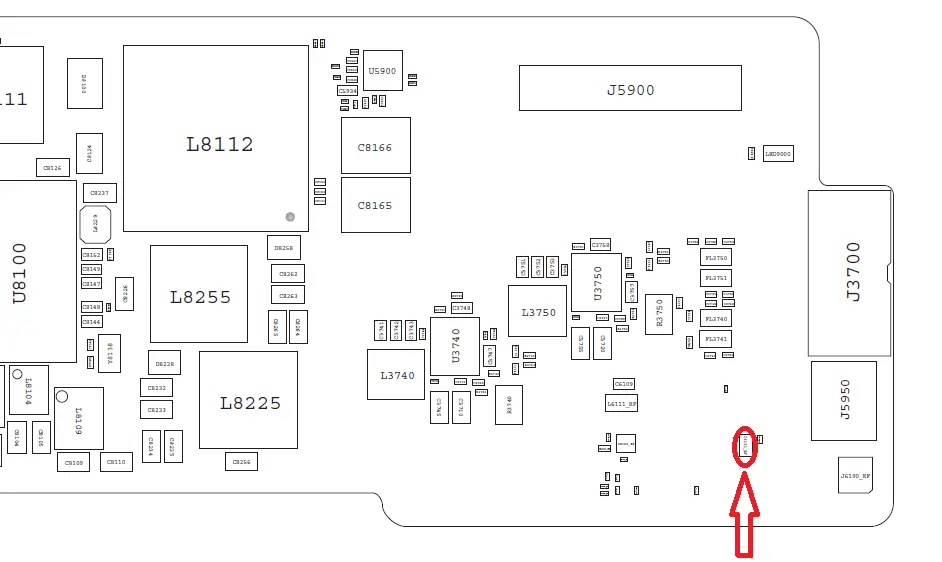

Problem solved this little sod had blown, it was showing full continuity instead of showing nothing incircuit. (dunno what it is)
Took awhile to find sits on top of the wifi chip and hidden well under the corner shield frame.

Hi superfandango,
I'm having the exact same issue.
I'm just wondering if you can give me a little more information on how you solved the issue?
Did you have to replace the resistor?
Any help would be appreciated.
