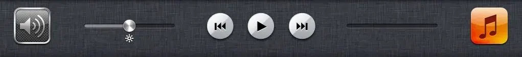

As topic says, sound just never workon any app nor anything else, even music.
This is how it looks after unplugging the earphones..
Any solution, please?

Hey there, somehow i bought a new cover (not screen cover) and changed with my old one.. Magicly the sounds worked lol
mcruea
Jan 2, 2012
Simpler solution
I had the same issue and found that by double tapping the Home button and sliding the bar to see the far left, there is a separate volume control for the speaker. Headphone control is separate.
