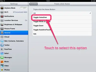

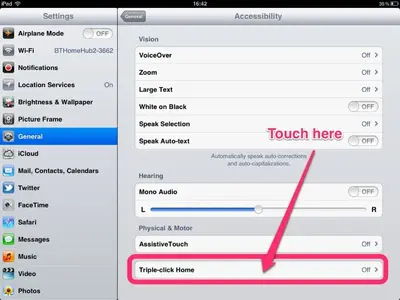

    To be able to quickly turn VoiceOver on and off the triple click home button function can be enabled.......

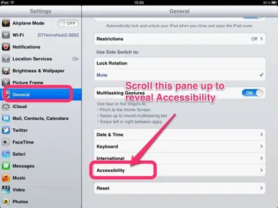

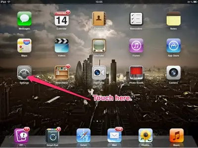

    To enable theVoiceOver function we first have to open the the Settings App. By default the App will open on the General Tab. Then scroll down to the Accessibility tab on the right hand side.this will then open the menu containing VoiceOver.........

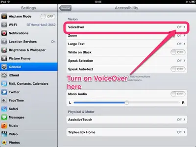

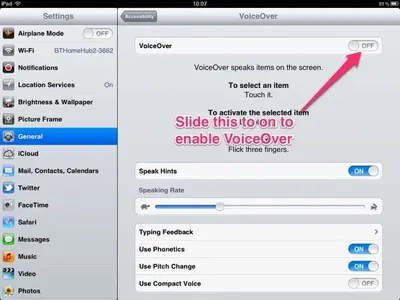

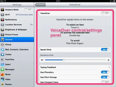

    You should now have the VoiceOver control panel open. So it's time to turn it on, but before you do you'll need to learn a few things which are different to normal. Firstly not all the normal gestures will work, secondly, we have some new functions which are.....
    Single Tap: a single tap anywhere on the screen will highlight that area and describe what is there, if it's text it will read the text and tell you if there is a function associated with it and how to operate it.
    Double Tap: this will select the item, for example it will turn a function in settings from off to on.
    Triple Tap: this will take you back to the home screen.

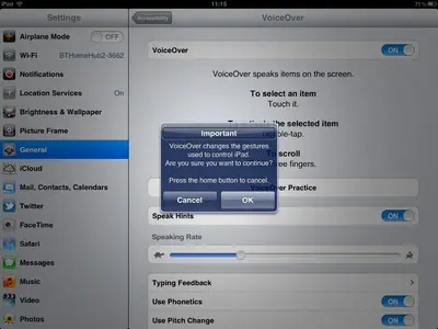

    So, now turn VoiceOver on. The first time you do this you should see this screen which just warns you that gestures settings will change.

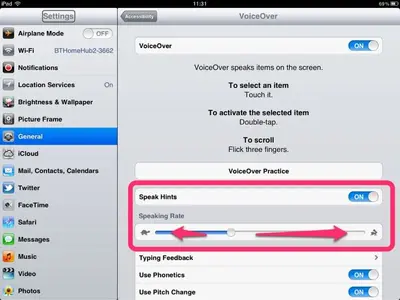

    Your iPad should now be talking to you and describing anything that you touch on the screen. So let's look at a couple of the key settings, Speak Hints and the Speaking Rate controller for the iPads speech. (NOTE: you can mute/un-mute VoiceOver by double tapping the screen with three fingers.)
    When Speak Hints is turned on it will also tell you if a function is available and if it is then it will tell you how to activate it. This function defaults to on and unless you are an experienced user it is probably best to leave it on.
    The Speaking Rate controller does what it says, it allows you to speed up or slow down the speed the VoiceOver speaks at. To adjust the Speaking Rate, double tap and hold then drag to the left to slow down or drag to the right to speed up.

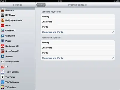

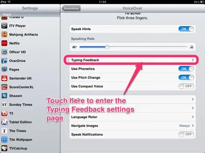

    Next we will look at Typing Feedback, by default this is set to both characters and words for both the software keyboard and hardware keyboards (it is not advisable to change these settings)......
    These settings are fairly self explanatory but should you be unsure, Nothing - no feedback when typing letters or for completed words; Characters - only feedbacks on typed letters; Words - only feedbacks on completed words; Characters and Words - feedbacks both individual letters and completed words.

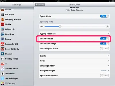

    The next setting is Use Phonetics......
    This setting works when typing, when switched on, instead of just speaking the letter being typed it will also speak the Phonetic Alphabet, for example, if you type the letter e, it will say "e" followed by "echo".

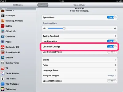

    Now we will look at the Pitch Change function.......
    When enabled this has a couple of functions. When typing a higher pitch is used when entering a letter and a lower pitch is used when deleting a letter. Whilst reading, the first word is read at a higher pitch and the last word is spoken at a lower pitch.

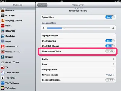

    The Compact Voice function changes the reading voice. This setting is either off or on.......

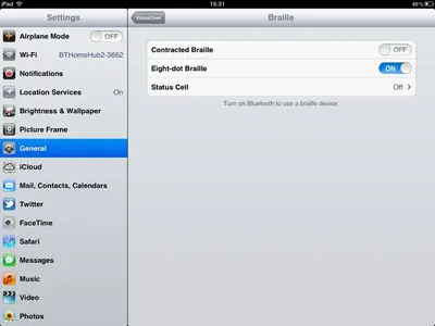

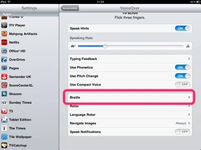

    Next up is Braille. iOS 5.x.x has support for many external Bluetooth devices. For a complete list check out this link http://www.apple.com/accessibility/iphone/braille-display.html
    The Braille settings can be found here.......

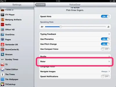

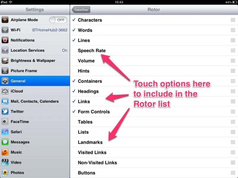

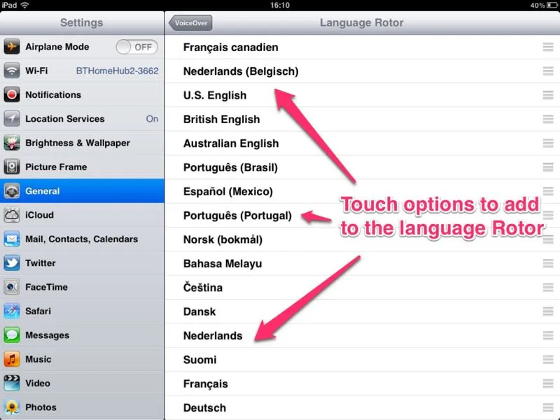

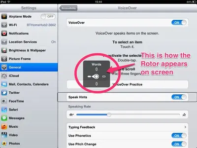

    The Rotor control is an amazing little secret of iOS VoiceOver. It is a virtual dial which can change the function and results of the up/down flick gestures (described further on in this guide). To use the Rotor control, place two fingers on the screen and rotate one finger around the other, the dial will appear and as you rotate different options will appear on the dial.......

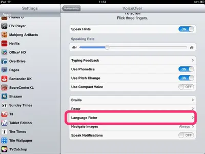

    If you are typing then the Rotor can be used to change the language that you are typing in.......

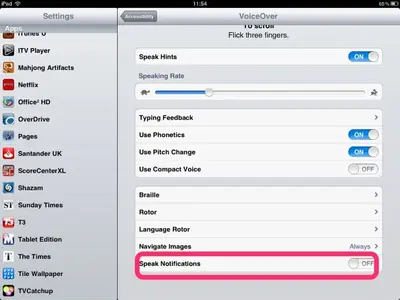

    Speak Notifications does exactly what it says on the tin, it will tell you what the notifications are when you unlock your iPad. If this function is turned off then it will just speak the time when you unlock your iPad.
