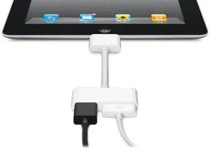

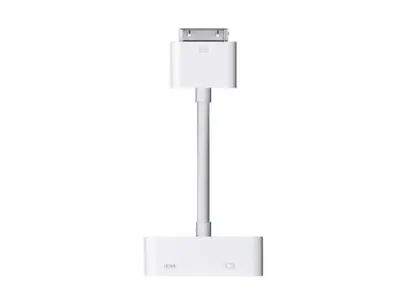

Hello Waterbabies - I'm assuming that you are using the Apple adapter (below left) and that you have the adapter (and power cable, as needed) attached to your iPad as shown below (right)? The black cable in the second picture is the HDMI cable going to your TV.
For me, I would do a step-wise testing of each of these components, e.g. if you have another iPad available (your own, a friends, or a visit to an Apple store), then make sure that cable is still working; also try another HDMI cable and/or try all on a different HDMI TV. Since you tried all of your HDMI slots on the TV and selected the proper source I'm assuming that your TV is OK. I'm also assuming that your docking station on the iPad is functioning properly (any problems w/ other connections?).
I would also suggest, if not already done that you 'Restart' and if not effective 'Reset' the iPad and try again - good luck and please post back your results - might help others! :)
