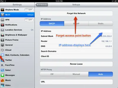

other suggestion is to forget the problem access point on the problem iPad. Then create it using the OTHER function under WIFI connections.

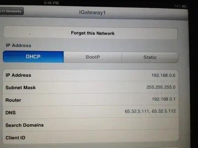

Can you post screen shots of connection details and post router config?

Considering the trigger event was the upgrade of the ipad1 to iOS 5.1 I really would like to see screen shots of the iPad settings for this access point. I am looking for the same screen shot as the one below. It would also be helpful to see the same screen shot from the working iPad2 that has no issue connecting to the problem access point.

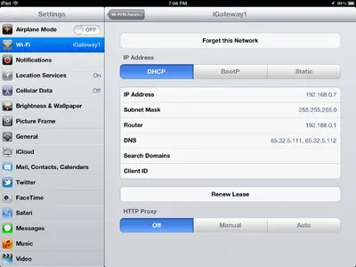

Teddie_C said:
This one is my new iPad third gen.
<img src="http://www.ipadforums.net/attachment.php?attachmentid=16539"/>
This one is the one that doesn't work.
<img src="http://www.ipadforums.net/attachment.php?attachmentid=16540"/>
