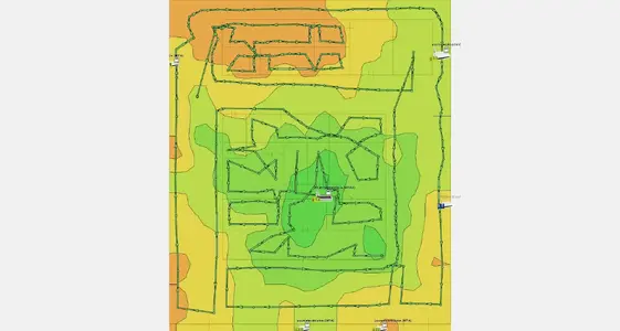

I took the test again with a newer router and got better results. The program I used was Heatmapper (PC) from Ekahau. Image shows signal strength in and around our house.
<img src="http://www.ipadforums.net/attachment.php?attachmentid=12393"/>
That's kinda cool.. :-)
Was that performed with a laptop as you walked around the property?
Thanks
