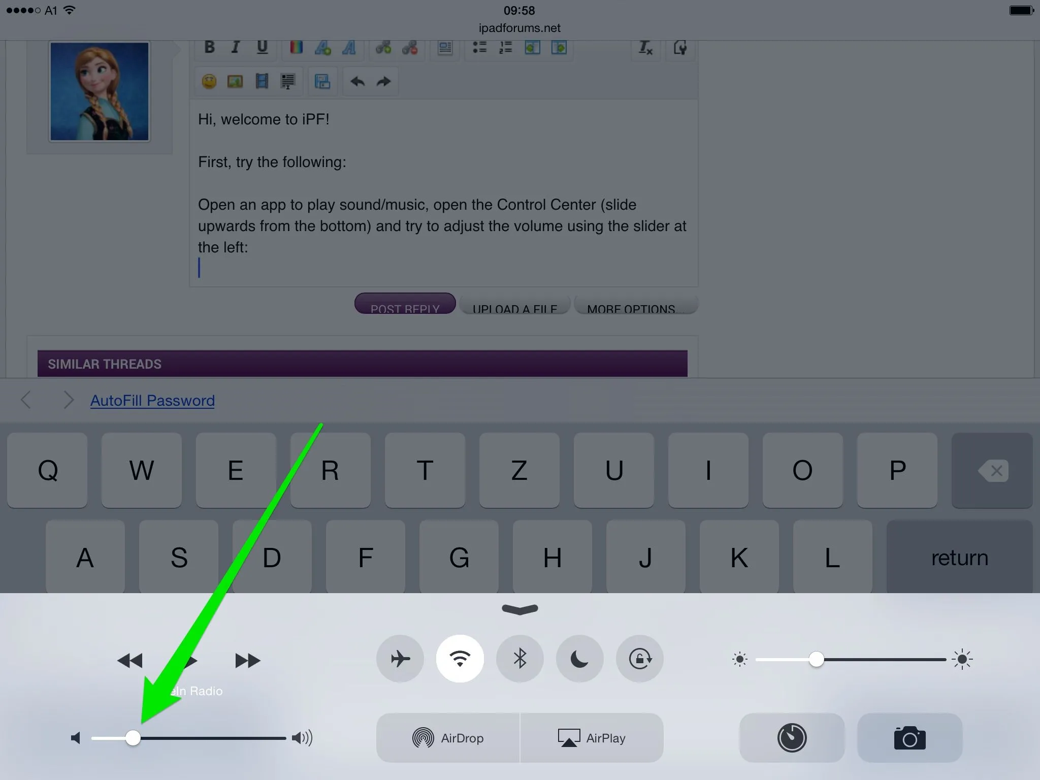

Hi, welcome to iPF!
First, try the following:
Open an app to play sound/music, open the Control Center (slide upwards from the bottom) and try to adjust the volume using the slider at the left:
Turn off Bluetooth in Settings - Bluetooth.
If your iPad is in a case, make sure the speakers are not covered by it.
Use a brush to clean speakers and connector. Do this cautiously. Use a clean and dry brush with soft bristles.
Hope that helps.

You took me by surprise by your fast reply!
I should have said that I usually play sound through external, Bluetooth speakers but had tried my iPad with both internal and external speakers - both were quiet.
I have turned off Bluetooth and my internal speakers are back to full volume. Thanks!
Now I just have to work out how to get my iPad to drive my Bluetooth speakers!
