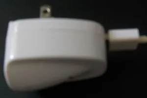

It's an iPad 3, 32 GB, refurbished
The iOS is 8.1.2 (12B440)
AC adaptor
  • 0.3a, 50-60HZ
  • Output 5v 2100mA
Model MC744LL/A
Modern Firmware 5.3.00

That does not look like the original AC Adaptor*. If you still have the original, give it a try. A lot of the cheaper adaptors are exactly that, cheap, made of cheap components that barely meat the minimum safety specs.
Anyway, you need to try a second AC adaptor, if for no other reason than to eliminate it as the possible source of the problem.
* I can't see the manufacturer of the device, so it's possible it is a great product. Griffin and Belkin make good, safe, reliable products. There are others. In general, they cost less than Apple's adaptor, but more than the super cheap stuff you see on Amazon.

The charger that came with it does not have a make or hint of wattage, although it did charge the iPad until this problem....I bought a Griffin > http://store.griffintechnology.com/powerblock-with-lightning-cable-12w Did not solve the problem, but this seems to rule out the cause being a bad charger.
