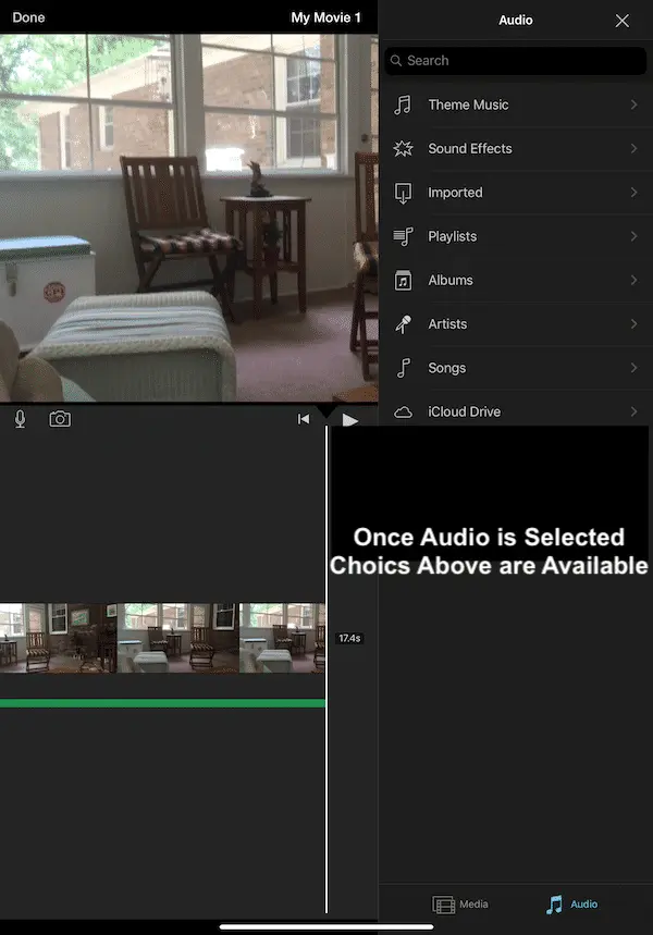

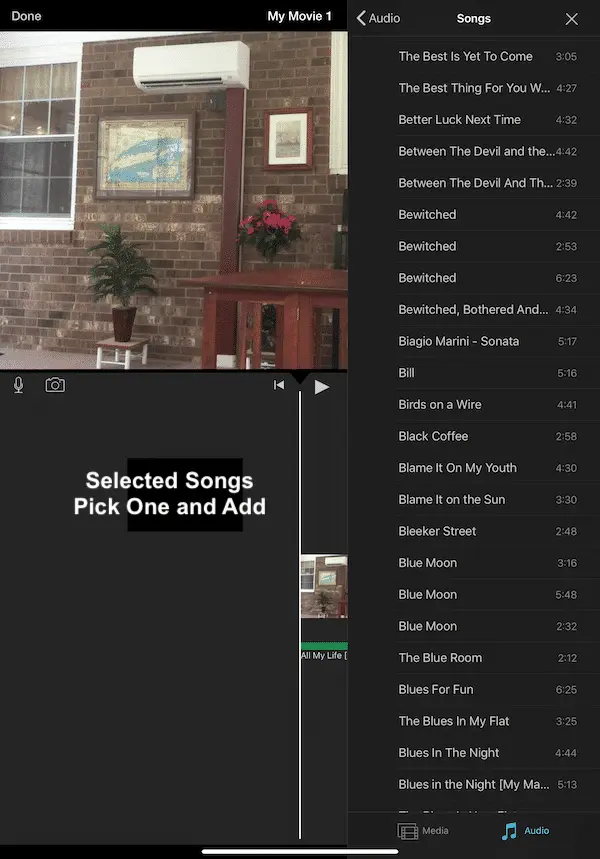

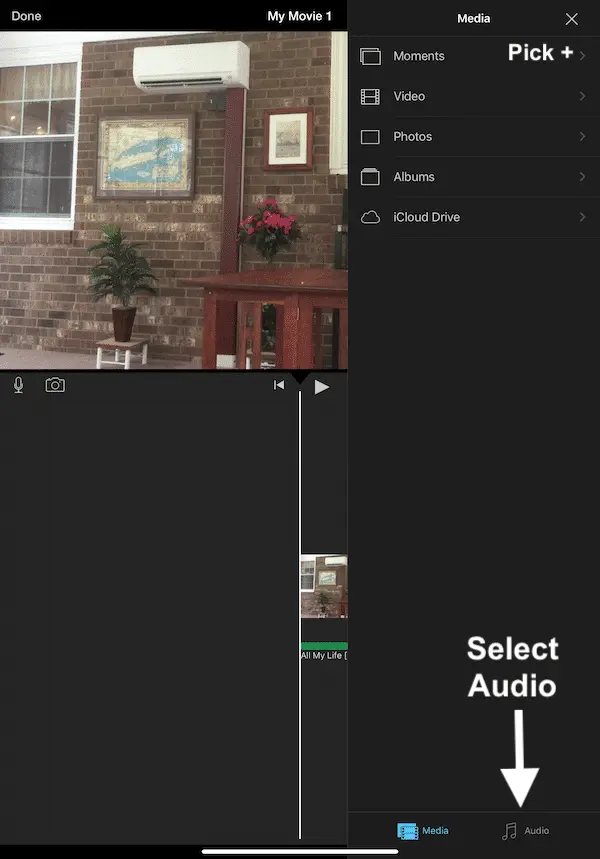

Hi again Majnoon - the link given previously may help - just gave the steps a try on my iPad Pro - had an old movie made in iMovie of my porch - brought in the movie and selected the 'Plus sign' in the right upper corner (first pic below), and then chose 'Audio' at the right bottom; next an 'audio menu' appeared and I picked 'Songs' (2nd pic); final pic, the song list appeared (from my Music app), pick one and brought it into the movie - SO, if you can get your recorded MP3 into the iPad's Music app, delete the sound recorded when the movie was made in iMovie, and finally add the MP3 as shown in the images - seems like the method should work.
As to recording directly onto the iPad, the only way that I can think of immediately is to simply let the native speakers do the recording, as iMovie does - this would take some adjustments for 'loudness' and the quality would likely not be what you want (of course, may vary w/ the model iPad used); the only other inputs on an iPad Air are wired (earphone jack & lightning port) or wireless (Wi-Fi or BT) - I'm not aware of using these options for recording input (would have to research the web) - maybe others will 'chime in' w/ suggestions. Also, have you used GarageBand at all? I have little familiarity w/ this excellent app and cannot comment on its many features but there may be some 'work arounds', don't know? Good luck. Dave :)

View attachment 85002 View attachment 85003 View attachment 85004
