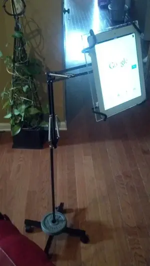

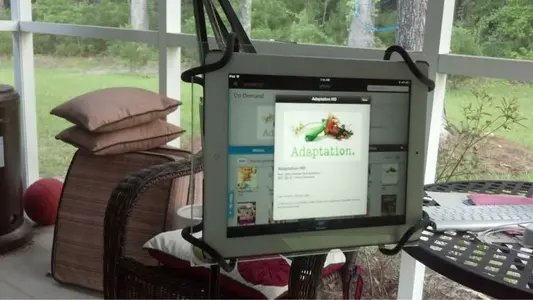

Recently bought the wife and myself the new ipads (looove it!) but it wasn't long before I discovered that they are not that comfortable to hold, forget laying in the bed with them. So I made this...now I can read, watch movies and type (bluetooth keyboard) all hands free! The cheapest I found on the internet was $45 for table top versions and $129 for the mobile designs. If any are interested I'll write up a how-to. As you can see it's still a little crude, the stand is great if the ipad remains close to the base but if extended out too far it wanted to teeter over so I need to add weight to the base. (See my temporary fix, weighted using weights)

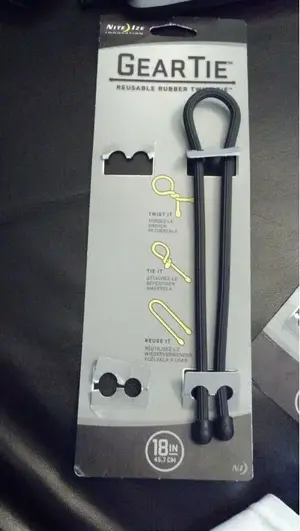

Materials:
1 Magnifier Floor Lamp ($35) The lamp is made by Home from there StyleSelections part # 0328687 (see pic)
1 8x10 and 3x4 piece of (1/4 or 3/8 inch thick) plexiglass - $8 for 18x24 sheet. Lowes will cut it for you. From the one 18x24 sheet I had two 8x10 cut. 1 for a spare in case I messed up the first or if the wife wanted one.
1 (2 pack) of GearTie reusable rubber twist ties - What can't you do with them? ($4.75) (see pic)
12 (6-32x3/4) Flat Slotted bolts w/nuts ($1.75) and flat washers ($.79)

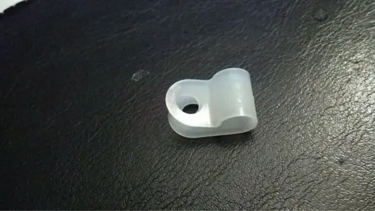

8 - 1/4 Nylon or metal clamps and (see pic)
Drill with countersink drill bit.
I think the attached photos will explain the rest.

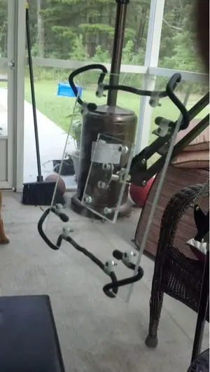

When drilling your countersink holes remember to drill your countersinks in the side of the plexiglass that your ipad will rest on so the the screw heads will be recessed into the plexiglass and won't scratch your ipads back panel surface. Be sure to lightly sand the edges of your plexiglass and around screw holes to remove any rough or sharpe edges.

The cool thing about the GearTies is that you can really configure them on thee plexiglass to meet your specific design needs. My ipad has only the thin back shell protector and I fitted it with the GearTies before anchoring them into place. The way I used the GearTies works so well because it stabilized the ipad perfectly for 360 movement but it wasn't my first design approach, play with it. post you design when your done. 3 hrs max.
A few other mods that would improve my design: 1). Reduce the size of the plexi back board from 8x10 to 8x9 because when pulling back the GearTies to release the ipad they rub against the plexiglass.. 2) Attach a 6ft extension cord to the stand with tiedowns to easily charge the ipad on the stand..
