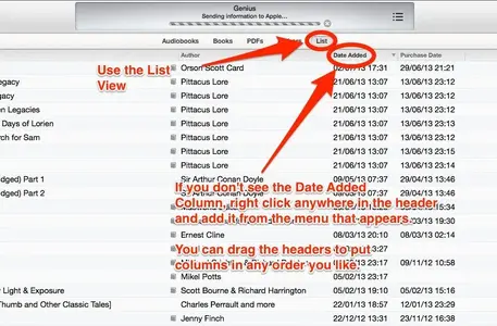

Two ways.
One: Select the Books library, then the List view. If you don't see the Date Added in the column headers, right click on the header and turn it on. Click on the Date Added header to sort. You can change the order of the sort by clicking on it again.
This lets you see a nice list, but you'll need to make note of what books you are concerned with for when you are setting up the sync. Which is why I recommend this next method instead.

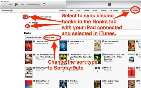

Connect and select your iPad in iTunes on the computer. Go to the Book syncing tab. Choose the Sycn Books and Selected Books options. At the top of the Selected Books list, you can change the sort type to Sort By Date.
