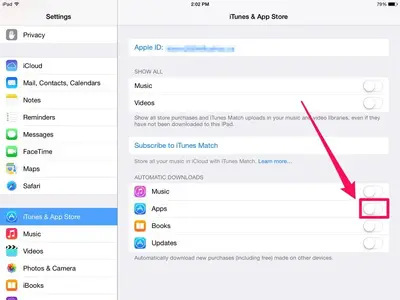

2. When my wife add a new app to her Mini it also shows up on my Ipad. Our pc's are connected by a home wireless network. How can I prevent that from happening.

In answer to your second question, you must be sharing the same Apple ID. To stop apps downloaded to your wife's iPad from automatically downloading on your iPad as well, go to Settings>Itunes&App Store and turn off automatic app downloads. This will stop the apps your wife downloads from appearing on your iPad.
