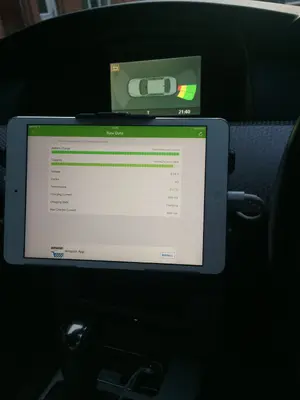

Just bought a 2.4A 12W Belkin car charger and headed off to work 30 minutes drive. Instead of losing 2-4% battery life I've gained 5% whilst using the iPad same way. If battery life app is anything to go by then its charging rate is around 575 mA on Belkin adapter and around 150 mA connected to iPod interface. Does anyone know if iOS reduces the charging rate if a accessory is connected like some Androids? Or could it be Dension isn't capable of outputting the current they claim?

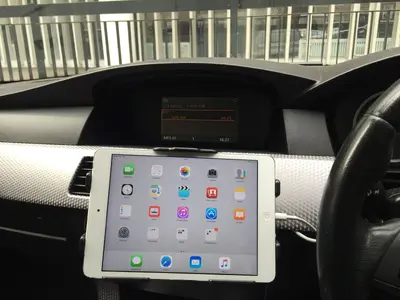

On my way back where I usually loose another 2-4% battery life. I've decided to give it another go plugging it into iPod interface but without selecting iPod on radio so it's charging only and no accessorys are connected. It's charged similarly to how it did plugged into separate charger, battery at 100%. So it does seem like iOS does the same as Android.
