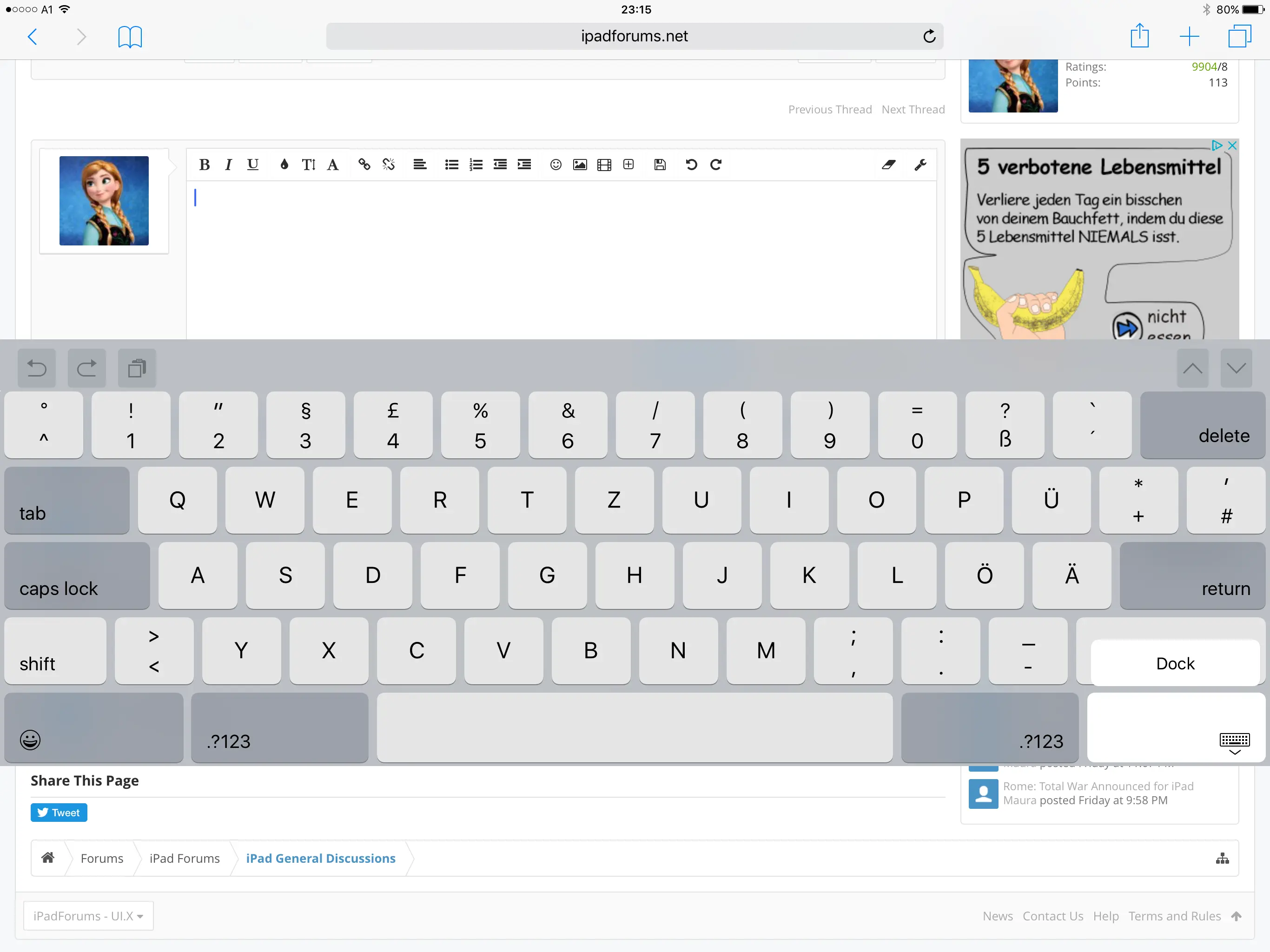

After reading your description, I suppose you split and undocked your keyboard. To undo this, press and hold the keyboard key at the bottom right of the keyboard. When something like "Dock" appears, slide to it (don't lift your finger), to get your keyboard back to the bottom.
This is a screenshot from an iPad Pro (2015), where you don't have the option to split the keyboard. Your keyboard will look similar, but not exactly the same.
Hope that helps.
Hope that helps.
